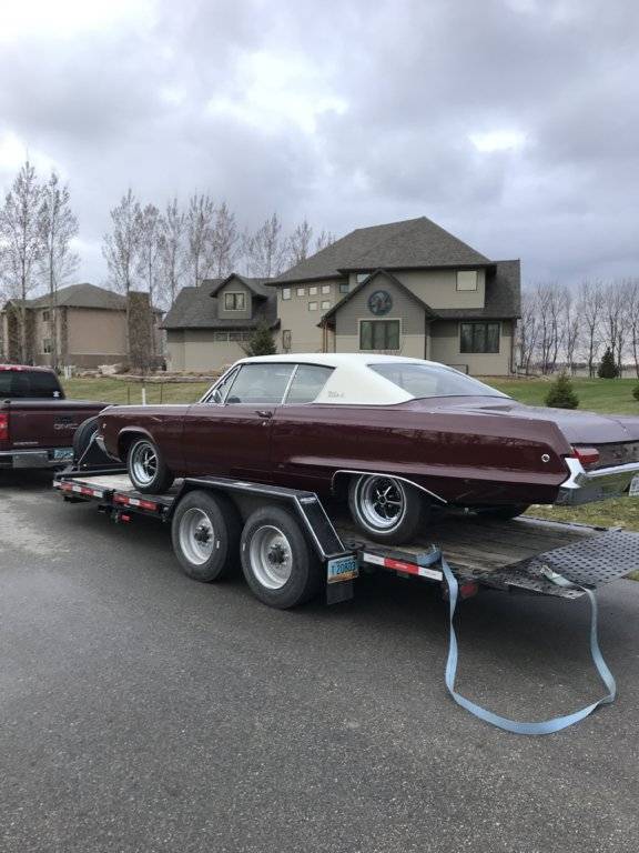

I couldn’t get the straps I had around the axle and under the brake line. I used the holes in the rear frame rails that the original transporters probably used and the pockets in the front sub frame and cinched it down compressing the suspension. It rode quite well.

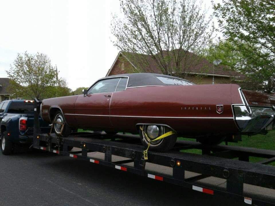

As long as your anchor points are close they would. Although it would be pretty tight getting up in the wheelwell with the strap to loop over the tire.
Guess it can be done. Found this pic. Doesn't look super tight. This was my 72 coupe shipped from Ohio.
