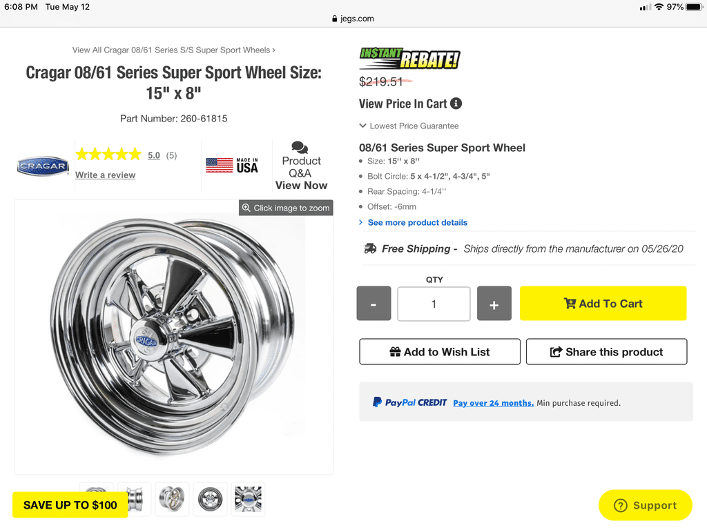

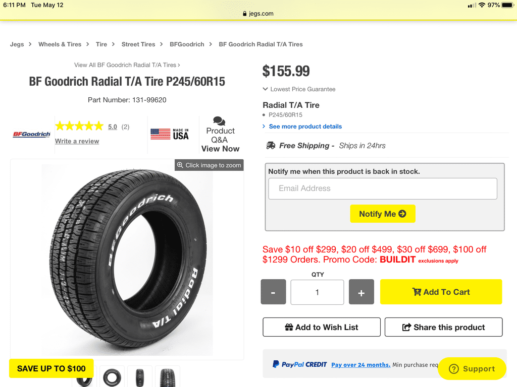

My 65 fury III is ready for tires and wheels, I’am not running fender skirts also I installed new leaf springs and I think that give me a little more height? I will post the tire and wheel combo I want on it. If someone knows if this fits please let me know, thanks.
My 65 fury III is ready for tires and wheels, I’am not running fender skirts also I installed new leaf springs and I think that give me a little more height? I will post the tire and wheel combo I want on it. If someone knows if this fits please let me know, thanks.View attachment 375386View attachment 375387

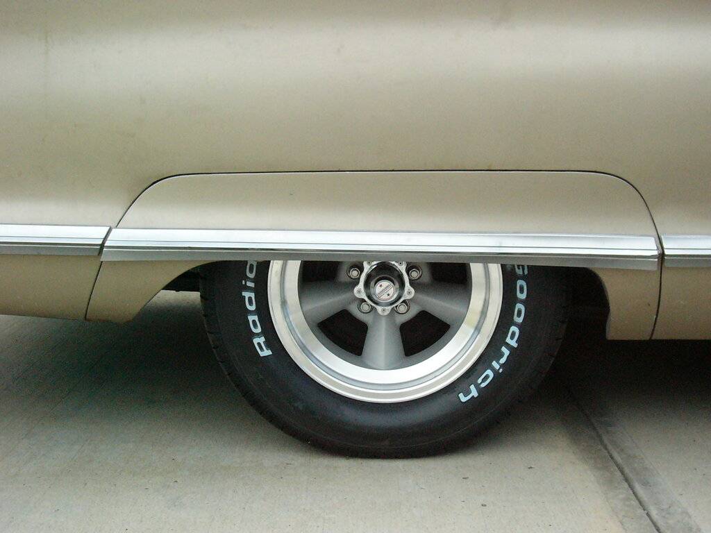

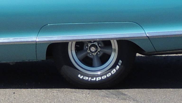

Might I suggest to stay away from the 245/60. They are too short a tire (that will be even more noticeable with a slightly raised rear and no skirts), and far harsher than a 235/70. BTDT. The 235/70 fills the opening better. These are on a 7" wheel. Here's a comparison...
245/60...
235/70...
And why the love for these now overpriced BFG tires. They just are NOT that good to be worth the price. You can by other radial lettered tires for about $100 each. Depending on size.
Hey 300 Rag thanks for your input , it’s hard to tell the difference with the skirts but it looks like it fills it in better.

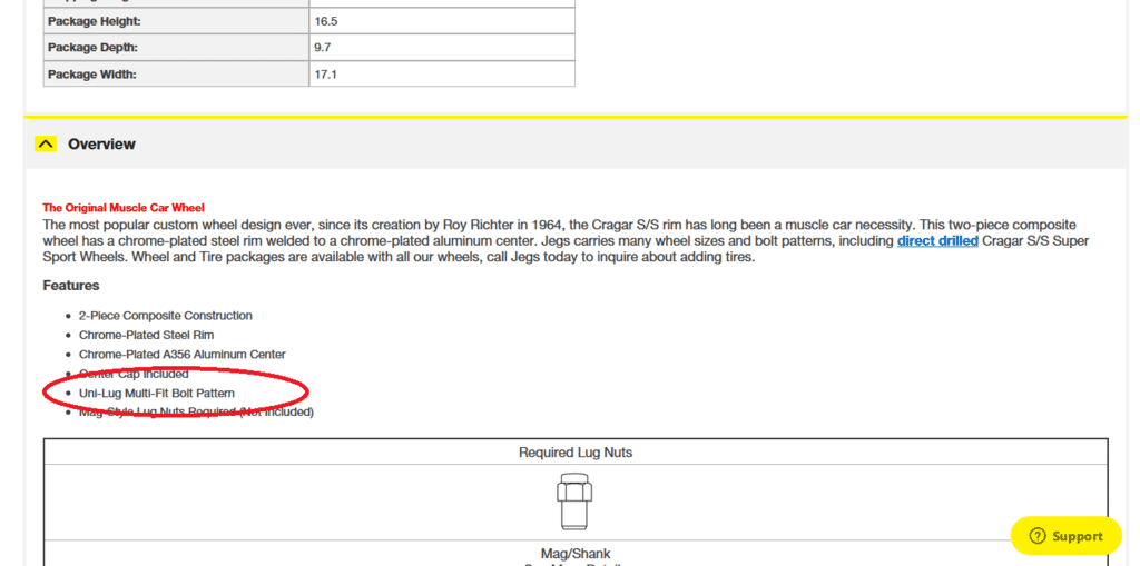

That wheel also appears to be a uni-lug. You should stick with a dedicated bolt circle wheel.

Hi 300 Rag , I like the looks of your 235/70r15 what are you running on the front ? Also if I go with a narrower tire on front would it be smart to go with 7” front and rear ? I think I will go with the direct drill hole rims . Thanks for your advice.

Also 235/70-15. I'm a believer in the same tire on all four corners.
245/60...
235/70...
Those 235/70s look great. A couple questions:
What are your wheel specs? 15x7? What back spacing/offset?
Are you running disk brakes up front? Do those wheels clear them?

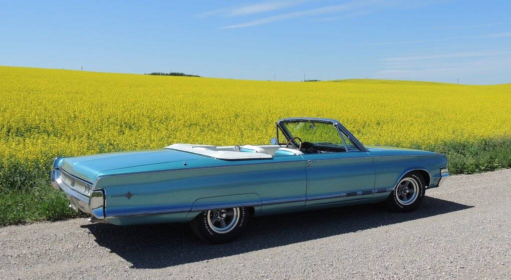

Looks great,, what a car!

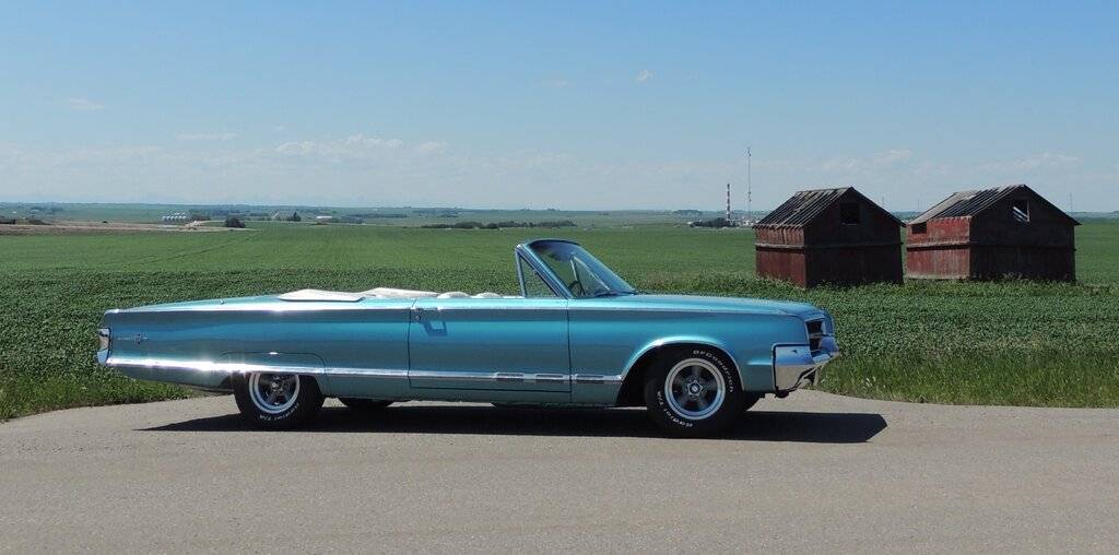

I vary somewhat from that statement. I like all 4 tires the same diameter but different sizes front to back ,at least on this car that is what I prefer. The vert above I like that all 4 are the same.
I run BFG 235/70/15's in front on 15/7 rims and in the back 275/60/15's on 15/8 rims. They both have the same diameter [28 inches in diameter] but obviously different widths. All four steel wheels are OEM reproductions from Wheel Vintiques.

Those are 15x7. They are 3.75 BS from what I recall, but that was in '06 that I bought them. It's an all drum car, so not sure about clearance for discs.

I just like all the same for rotation/wear purposes. Probably not a concern for this car, but old habits die hard.

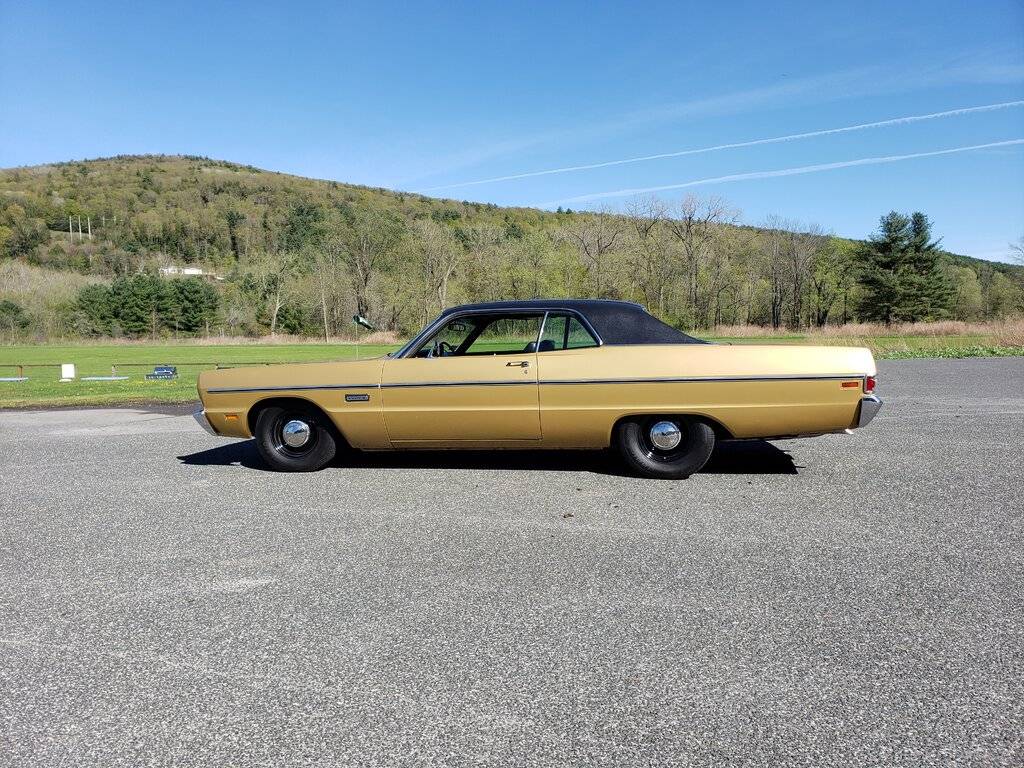

Do you have a side view of your car?
