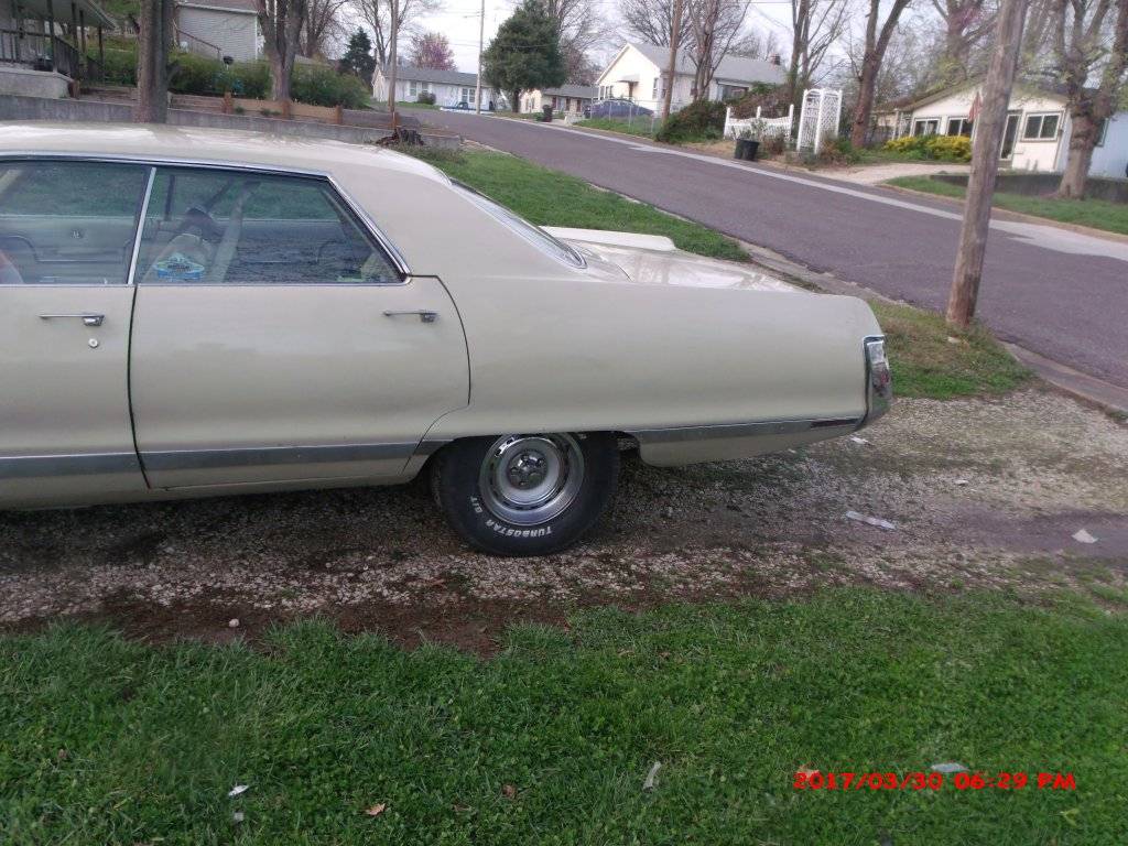

i have them on the back of my new yorker but they r raised white letter
