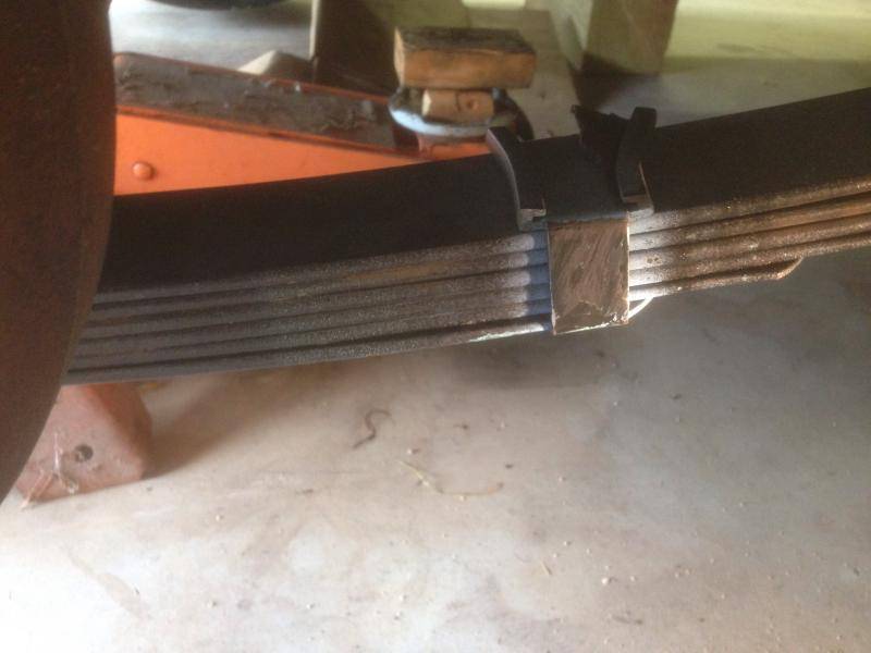

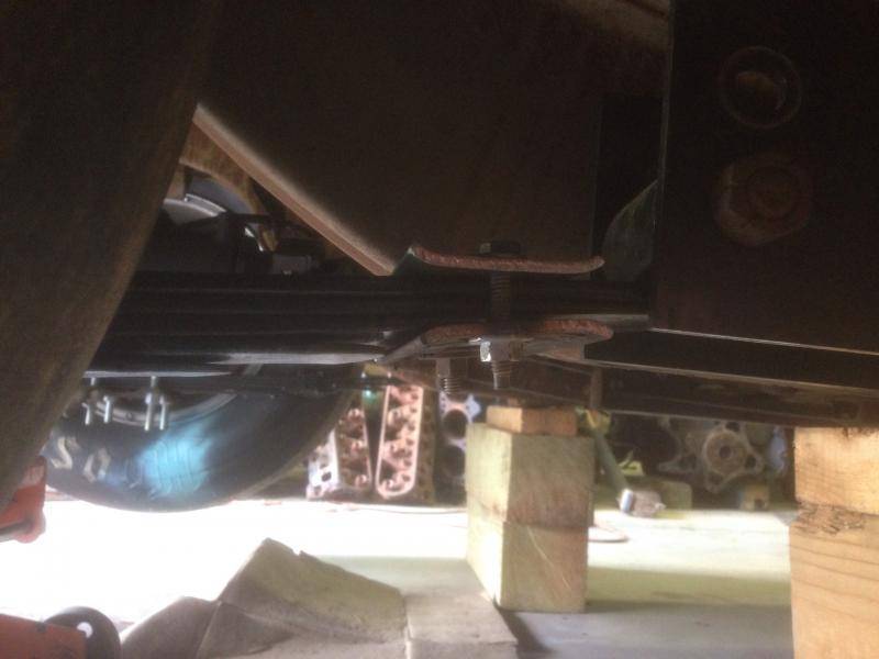

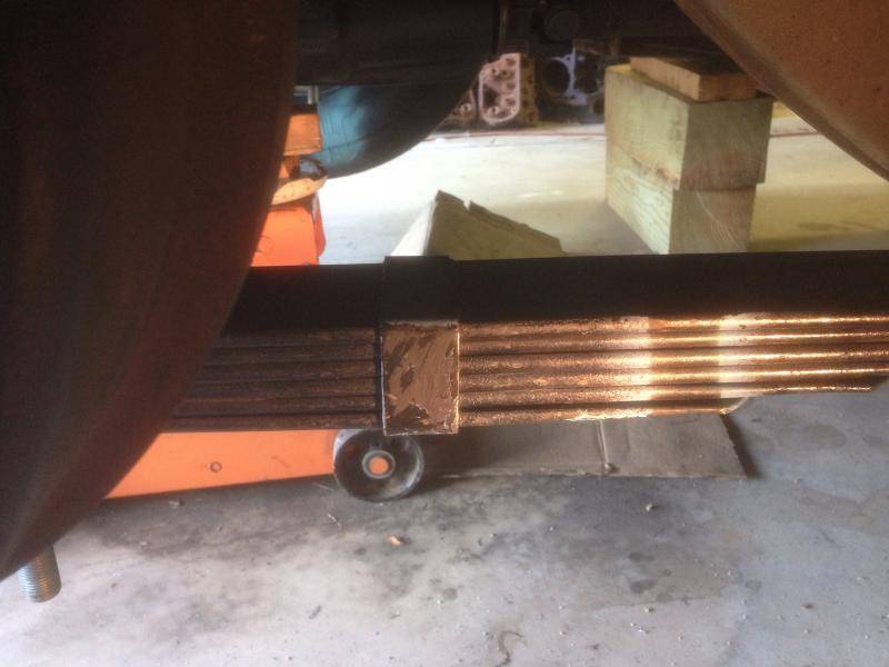

Still having issues with tire rub on "The BEAST'. It's fine going straight, but as soon as I turn the tall slicks lean over & rub on the front leaf spring band clamps. So I repositioned the pass side back to clear the tire & then made a bolt on clamp to hold the front part of the leaves. Not pretty, but seems to work. This should stiffin that side up a bit too. Headed to the track in the AM. Need to adjust the valves. I can hear them clicking on the driver side. I did the pass side a month ago when i had that head off. Haven't done the driver side in a long time. It will have to waite. Might cost me a little ET, but I'm exhausted. Taking the rest of the day off so I can be fresh tomorrow. I'll let ya know how things work out.
