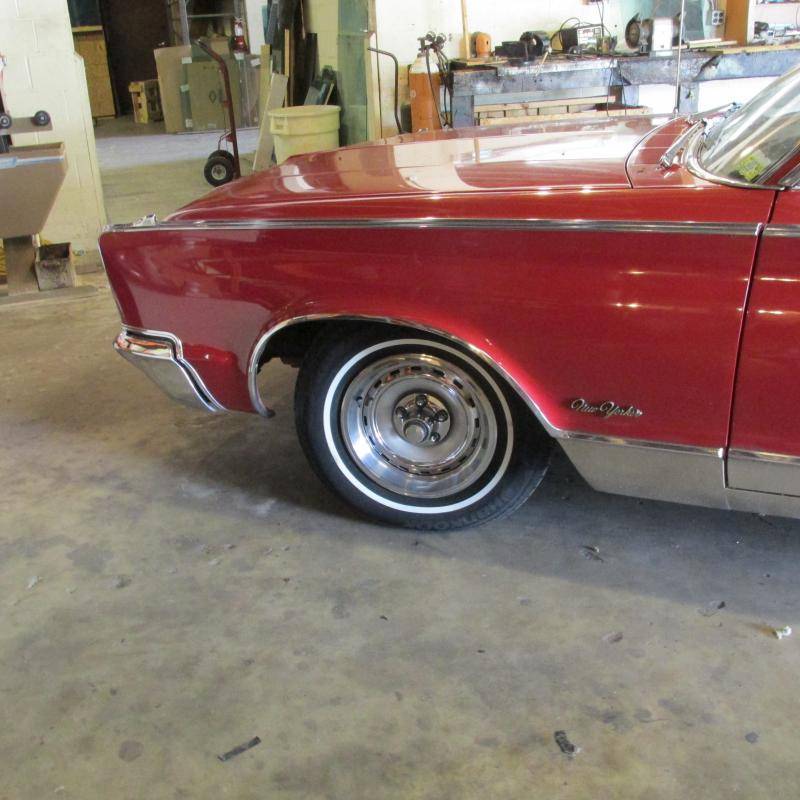

I put this together based on some research I did last month for tires for my 300L (8.55-14 narrow whitewall OE) and my 67 New Yorker (8.85-14 narrow whitewall OE). I looked at both big 14's (8.00/8.25/G78-14 and larger) and big 15's (7.10/8.15/G78-15 and larger) and was disappointed to find many of the tires which were available only a couple of years back are now extinct.
