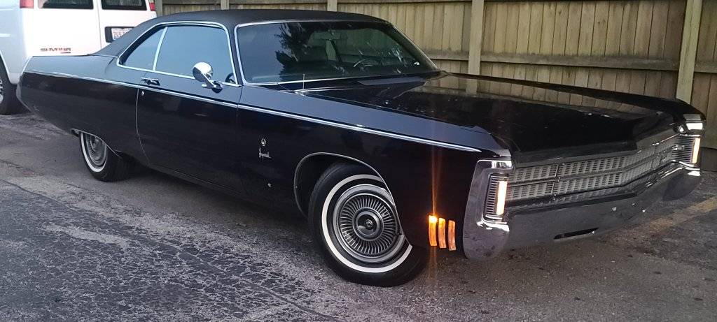

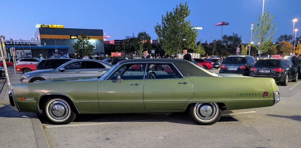

I have 235/75/15s on my 72 Imperial.

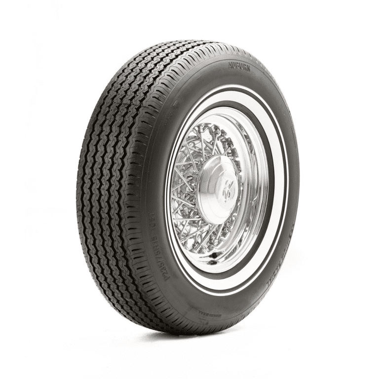

I have purchased two sets of the Nexen Npriz AH5 235/75r15 White walls. Very good tire at a good price with the correct load rating.

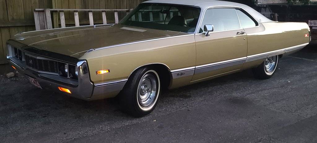

I went with a 235/70r15 over the 75 series on my 73 Newport.
I found there were more passenger car tire options In s 70 series. Most of the in stock 75 series tires were LT (light truck) tires. I also find the 70 series fit my car better (looked better).
