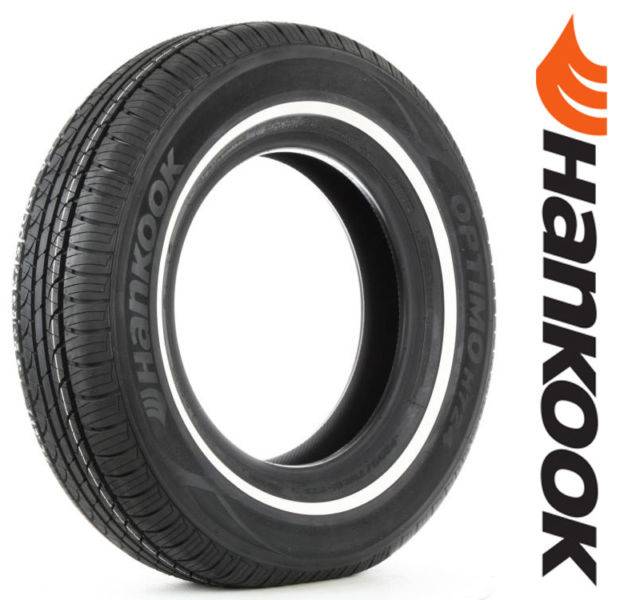

I tend to prefer the Hankook Optimo 724 white stripe tires that have a higher load (XL) and speed rating (108S) than any other such size tire that I have found. While I am not crazy over the sidewall design itself, I don't really notice it when they are on the cars since there is so much other nice stuff to look at on a 1971 Chrysler 300! The information below is from the Discount Tire Company (aka knows as America's Tire Company). They are also one of the few tires approved for use in Europe for the Autobahn, etc.
BETTER
Hankook
Optimo H724
P 235 /75 R15 108S XL WW
ITEM# 10986
70,000 miles manufacturer warranty
XL Load Range

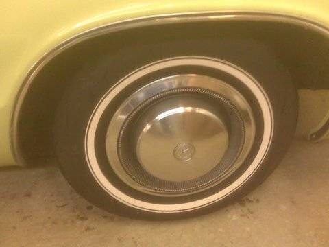

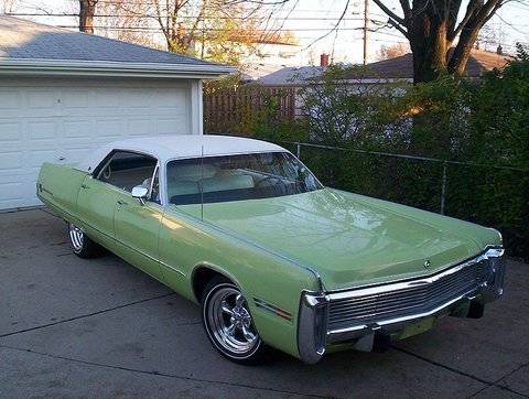

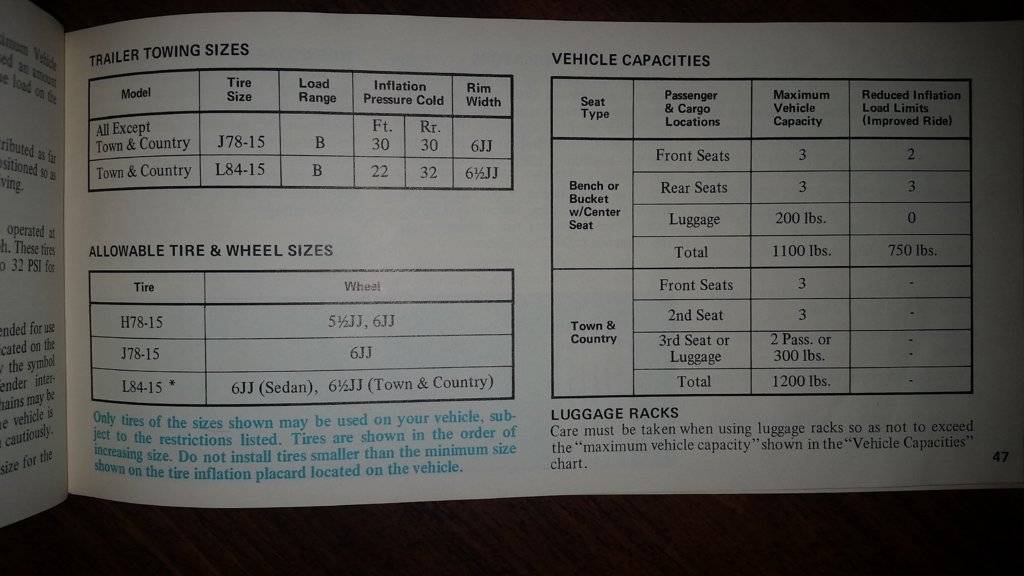

The OEM tires were probably H78x15 Goodyear bias-belted whitewalls. If you go by the section width measurements, then a P215/75R-15 radial would be the equivalent, but most use the P225/75R-15 size. An alternative would be P235/70R-15
I believe the Hankooks would be a good choice, especially as they are available without having to get into the repro tire vendors (and $200.00/each prices!). Many local tire stores usually have then, too, which might be even better if you're away from home and something might happen.
Those Hankooks are supposed to have (according to their website) the "outer belt cap" for added tread stability, better handling, and other benefits.

I also just recently bought a set of Hankook optimo h724 tires for my 1969 300 and they look and handle very well. I was able to find them online at the Walmart warehouse with the white wall. Very reasonably priced.

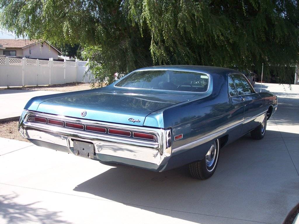

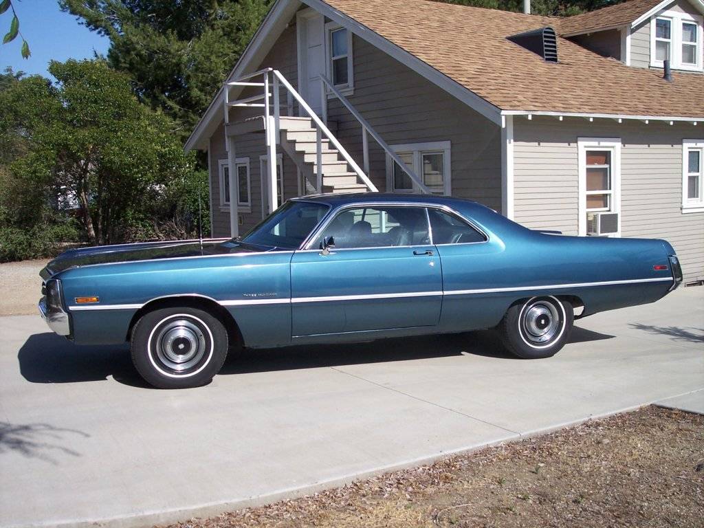

I would like to purchase a set of tires for my 1971 Chrysler 300. Are tires like Toyo tires' Proxes A20 used in vintage cars like my C-body?
How about a photo of your car? Don't see many of those very often on this site.
But I might be part of the reason for that. :)

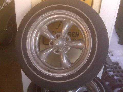

When I decided to sell the car (which I regret), I bought 15" Optimos, mounted them on the OE rims (how wide in '73? I don't know?) and added a pinstripe whitewall by removing the 1/32 of black rubber on the sidewall. The car's driving dynamic totally changed. Much less surefooted into a sweeper turn, more frequent steering corrections and just a feeling of "sway" that didn't exist with the 60 series 17" tires. There is no way I would have enjoyed the highway travel as much with those tires.
I still have another set of 17" aluminum Torque Thrusts and I think I'll mount up a set of performance SUV tires for the Royal Monaco. It's also what you get used to, I imagine. Right now, the Monaco feels like a slot-car compared to my tall-riding SUV, but I'm sure the 17s will make the Mastercraft's feel more like the Optimos.
There is a 17" aluminum rim out there that is designed to accept a 15" wheel cover. The extra diameter can be painted balck/white to mimic a whitewall. Never seen it in person, but I love the idea. Best of all worlds.
I"m sure you know I lean towards originality, but I don't sweat rims/tires very much since the changes are not permanent.

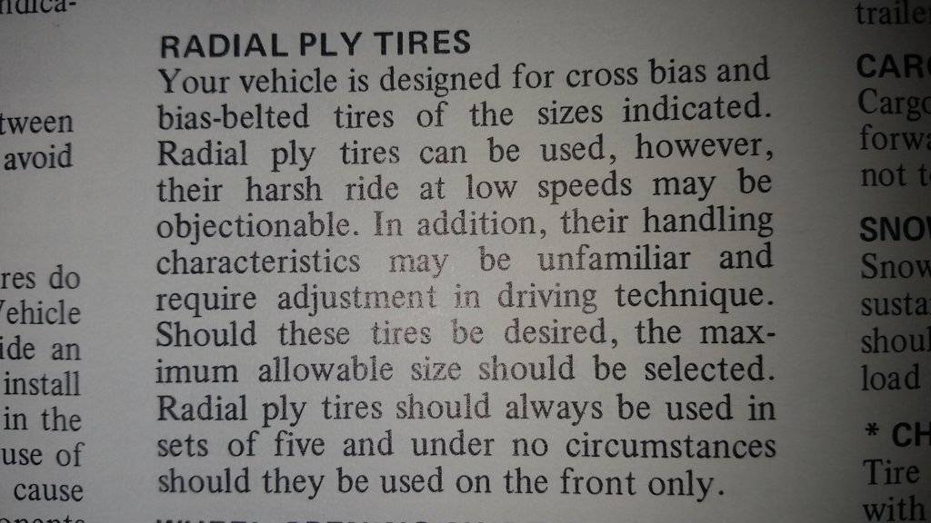

There are TWO criteria I use in looking at equivalent tire sizes. One is actual section width (convert mm to inches) and THEN the "revs/mile" number for that size. GR70x15, for example is about 750revs/mile, according to some of the later '70s BFG literature I have. P245/70x14 replaces the earlier H78x14 in the revs/mile spec. The P215/75R-15 is the old G78x15 or non-Pmetric 205-15 size. The slightly larger P225/75x15 size is what the earlier J78x15 was, which is the earlier 8.85x15 size. P235/75x15 hits the "L" size.
When I put the Pirelli P76s on my '70 Monaco in the later '70s, I chose the JR78x15 over the HR78x15 so it would raise the car's height enough that the rear factory duals didn't drag on some steep approaches. Remember THAT problem? And it worked. I read all of the Chrysler factory information on radial tires (which was in the '70 Owner's Manual) and might have been a little gunshy, but did it anyway. I experienced nothing of what I'd read about UniBody cars and radials, back then. Just a better situation.
When I saw my first set of Cooper Trendsetter SEs on a '66 Newport at Mopar Nats one year, I was impressed as they looked just right on the car. Tread width matched the OEM Goodyear Custom Power Cushion 8.55x14s in all dimensions and looks. Narrow tread and all.
For the '67 Newport, I went initially with some Kelly P225/75R-15 glass belt radials, for impact harshness concerns AND that size matched the dimensions of the earlier H78x14 tires. Those were replaced with a set of NOS P245/70R-14 BFG Advantage T/As. On '65 C-station wagon 14x6.5" rims. Those tires had some rolling resistance! 6-ply fabric belt radials.
To me, the best fit is the P225/75R-15 size. There's enough weight carrying capacity too. I generally run 30/28 tire pressures, possibly a little higher, so the tires are firmer and handle better. I've seen W23 16-slot Class II Road Wheels with P235/75R-15 whitewalls on a '66 Chrysler and they look pretty good, just a tad too big for my tastes. BTAIM.
The wider rim width keeps the sidewalls more vertical to the road. This will increase steering response with a little more impact harshness, but not so much it outweighs the handling benefits. A wider wheel is always better as long as strength is maintained.
Falls MasterCraft tires used to be sold through the Farm Bureau offices, in the '80s or so. Now, they are in more tire stores in rural areas, from what I've seen in TX. A good value line.
The pre-'69 Chrysler C-body cars were supposed to be more sensitive to radial harmonics in the 45mph speed range. Our service station guy had a '65 Fury III with radials designed for cotton trailers on it. Branded not for road use, but they worked fine on his '65. He like the highway ride, which is smoother on steel-belt radials and said the lower-speed harmonics didn't seem too noticeable. This was in the late 1960s or early 1970s. Yet some CAR LIFE readers with B-bodies said radials didn't ride well on their cars, but bias-belted worked great. Differences in tire brand? Other car/tire interactions? Many variables.
By this time, the current-design P-metric radials have most of those "old habits" designed out of them. Some seem to ride more like bias-belted than radials, by observation. I wish I could find some Michelins, but others have used the Diamond Back Toyos and raved about them. I concur with the "buy American" theme, but sometimes that isn't possible with tires. The Hankooks do have some very nice and sharp graphics on their sidewalls, though. Better prices than the repros, though, plus better availability. I suspect that if I had good performance from the old bias-belted, any current radial should be just as good, as far as that goes.
