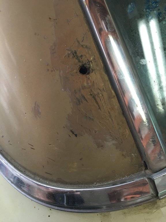

Just to give you an idea, this is next to the rear window trim on my Monaco. There's no way water "sat" on this spot but simply due to humidity there is rust through. Chrysler was good at many -a- things, sheet metal selection wasn't one.
