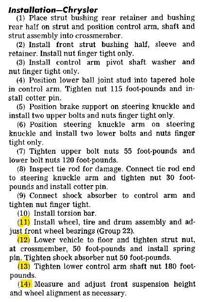

Something else to ask. Did you tighten all your control arm nuts with the car at normal ride height? If you tightened things with the car off the ground, you have a lot of tension built up in the bushings and the car is slowly settling as the rubber either spins in the shells or rips apart. If you used polyurethane bushings, this part wouldn't apply.

Did you tighten all your control arm nuts with the car at normal ride height? If you tightened things with the call off the ground, you have a lot of tension built up in the bushings and the car is slowly settling as the rubber either spins in the shells or rips apart. If you used polyurethane bushings, this part wouldn't apply.
Very good suggestion, Jeff. Easy mistake to make.
It seems "normal" to most folks to get everything back in place, with the arms hanging down, and tighten those shaft nuts. Even when you read the FSM it's not at all clear the reason for having full weight on the tires when you tighten 'em.
Put a paint dab on the threads and matching area of the nut to see if the adjusting bolt is moving on you. If not, and the rest of the suspension is in order, replace the torsion bars as it looks like the questionable one is bad and may break on you.....not fun if you're going freeway speed!
