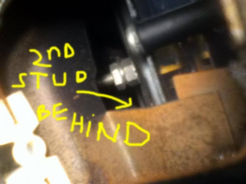

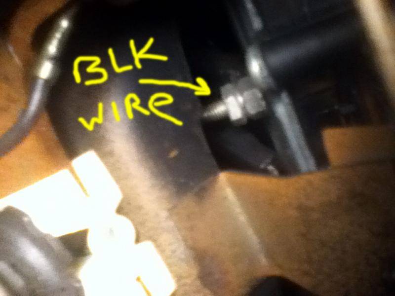

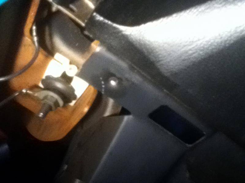

So what would I have more luck doing....try and go in behind the panel to get at back of "AMP" gauge (a nightmare) OR better to remove instrument panel from the front to get at it? What have you done? Its a total nightmare to go in from behind....steering wheel column bracket is sitting right there, its also blocking the second stud on the back of the amp gauge.
Affirmative. I was thinking that too after staring at the whole assy for about a half hour straight. I just want to get the wheels rolling again...driving Japanese.
