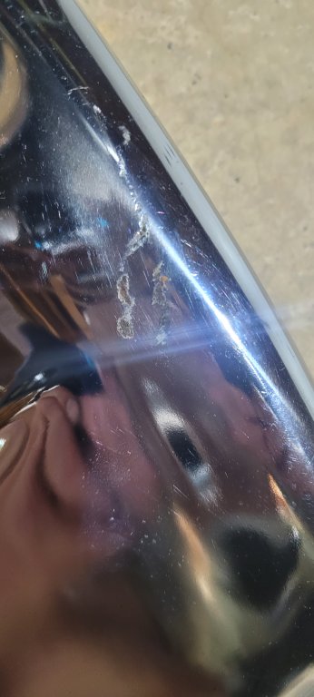

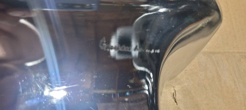

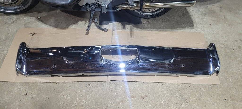

Last weekend I scored this really nice bumper for the NYer for next to nothing. The only problem is in both ends it has a scratch. Any ideas for how to make it less visible and slow future deterioration? If not I still got a killer deal.
Considering that one of the final stages of "chrome", is a polish, some industrial-grade chrome polish (on a buffer wheel) might work to make the scratches less noticeable or mostly removed?
A light acid will take the rust out of the scratch, wheel acid or hydrochloric acid works well. After the scratch is clean, keep a coat of wax on it to slow rust from retuning
I second the polishing method. Maybe hit the bumper with a clay bar before for a better result too. There’s probably crud wedged into that scratch, then go forward with a metal polish. Should make it look a lot nicer.
IMHO, there's not much you can do to make it look better. Nothing is going to match the chrome and it will stick out like a sore thumb.
I'd polish the bumper with my favorite chrome polish, Collinite #850 Metal Wax, and call it a day.
