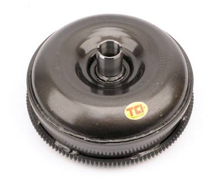

Oct 15, 2016 #1 67fury3kidd New Member Joined Nov 26, 2015 Messages 19 Reaction score 2 Location tucson arizona If o get the smaller style torque converter would i need a different starter?
Oct 15, 2016 #2 70bigblockdodge Old Man with a Hat Joined Jan 19, 2013 Messages 13,562 Reaction score 11,204 Location Avonmore Pa. No all converters that fit a particular trans, 904/727 come with a ring gear that works with corporate starter.

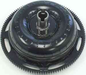

Oct 15, 2016 #3 commando1 Old Man with a Hat Joined Mar 10, 2011 Messages 37,611 Reaction score 39,026 Location Sebring, Florida See how they keep the ring gear the same diameter regardless of the diameter of the torque converter?
