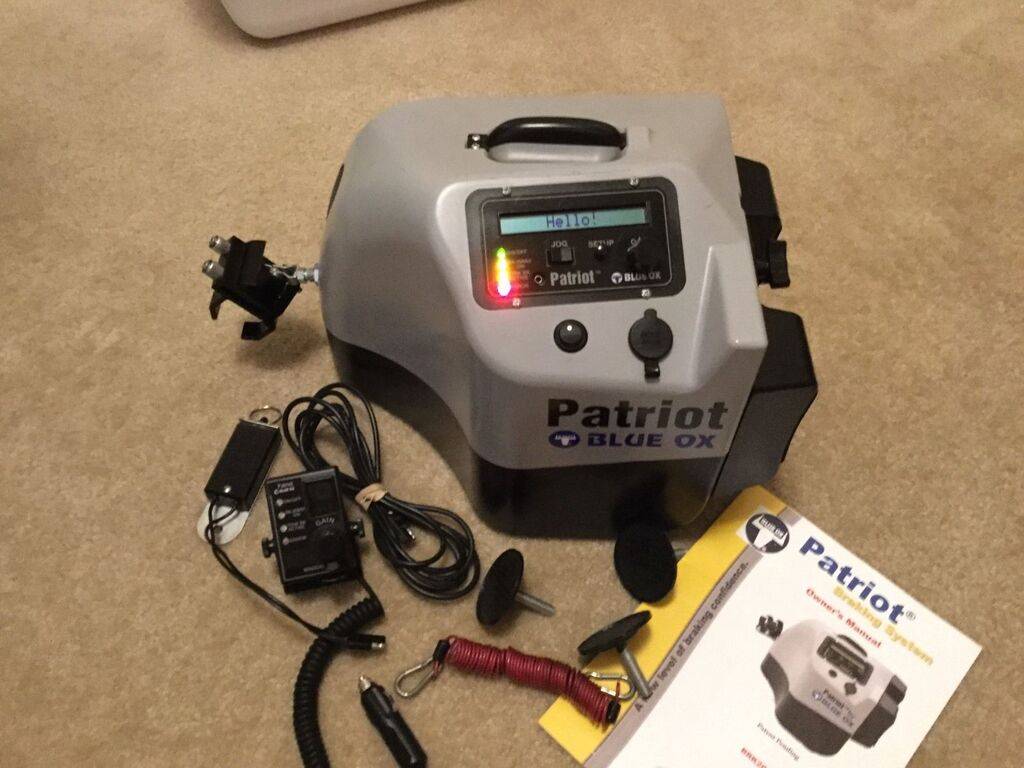

It has come back to me. My brake lights were activated when the pedal got pushed by the Blue Ox Patriot I used...
