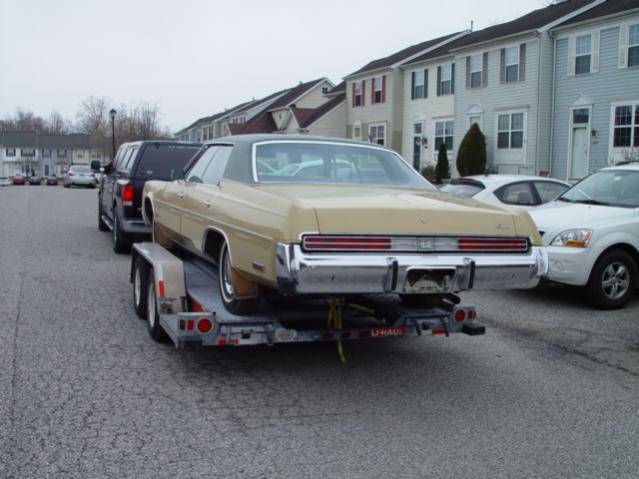

Just wondering if a U-Haul trailer would tow a 77 Chrysler Newport by chance? I see it's not a recommended setup even for a 2500 series Dodge Ram but, if I remember correctly I could of swore I saw someone who towed their C-Body on one. Just wondering if it will fit? Thank you in advance.
I have towed all the generations of C-bodies on a U-haul with my 6cyl. Base F-150. It's tight. Within inches. But it fits. So it ships.

Yes it will fit and pull comfortably.

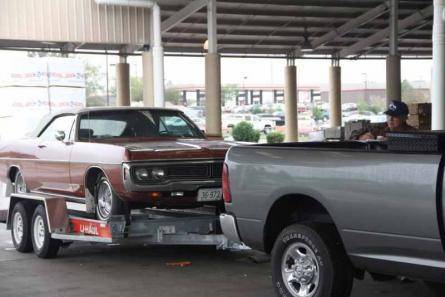

They rented one to me knowing I was towing with a 4X4 Dakota. I told them I was towing a 80 something Chrysler Lebaron..... I brought a 64 300 convertible home. No trouble towing.

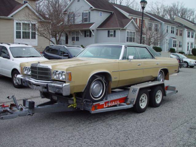

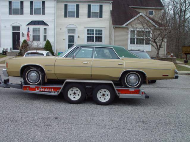

I pulled my 1978 Newport with my Titan. I forgot I was towing something most of the trip. You need the biggest 2 axle trailer U-Haul rents and them them that your towing an A-Body.

I used a couple extra ratchet straps to make sure she wasn't going anywhere.
