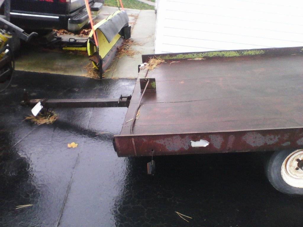

Ok so it's not a C-body but many of the resto techniques we use on the cars will apply here. This will be my winter project, I know lots of you guy's have used product's like Por-15 and Rust bullet. I want to know from experience what worked, what can be painted over, Etc...
I plan on cleaning the rust off, repairing any rust holes(there are some), rewiring it and new lights, new wheels and tires, new hitch coupler. After the rust is treated I will paint it with frame paint. The deck I will coat with spray on bed liner. I will build some wood sides for it also.
It's a old tilt snowmobile trailer that will be given new life as a utility trailer for lawnmowers, my kid's quad, dirt bike and what ever else we can think of.
Here's a couple of pic's of what I am starting with, sorry for the bad quality.

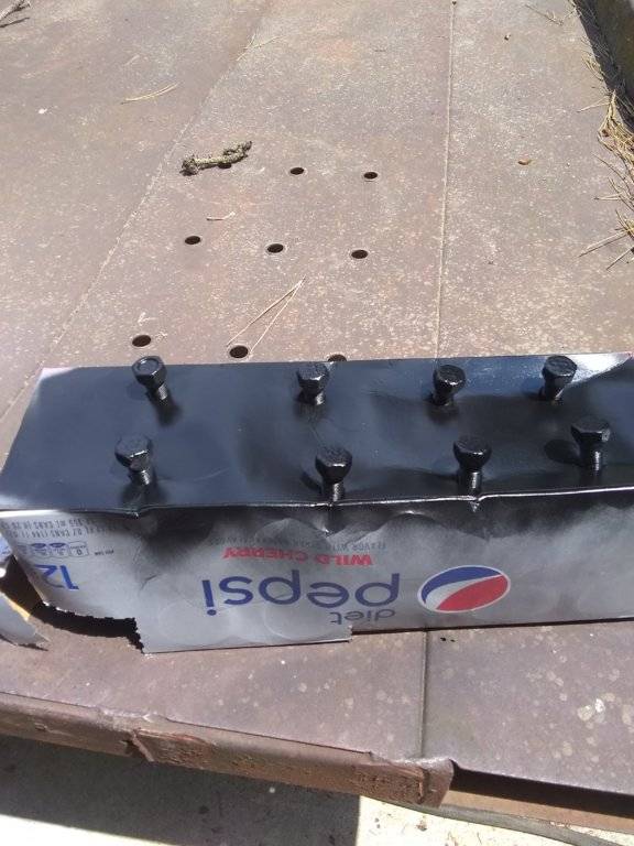

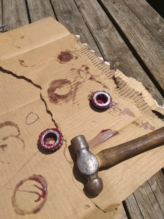

So this thing has been waiting for some love, I pulled the hubs, blasted them, packed the bearings and threw some paint at them
