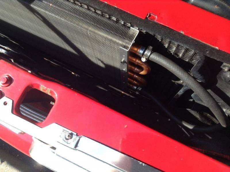

What aftermarket brand/size aux trans oil cooler do you recommend? 1970 Fury 3, 440/727/3.23 no AC. Realize this question has probably asked before, but searched using my title phrase and couldn't find the answer. Thanks for your help.

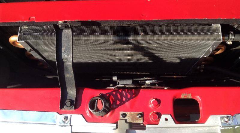

I used this one and it's very nice. I ran all new lines also. http://www.summitracing.com/parts/sum-g4969
It uses nylon tie straps and nylon buttons through the radiator cooling fins. Very easy to install and it's clean looking when it's done.
As far as hose routing, I was thinking: cut off the lines at the front of the stub frame, double flare the lines, and then run both hoses around the left side of the radiator. Is that pretty much what you did or did you do something else?
Yes, that's pretty much what I did. Worked out great. Don't forget to use trans (rubber) hoses, not fuel line.
