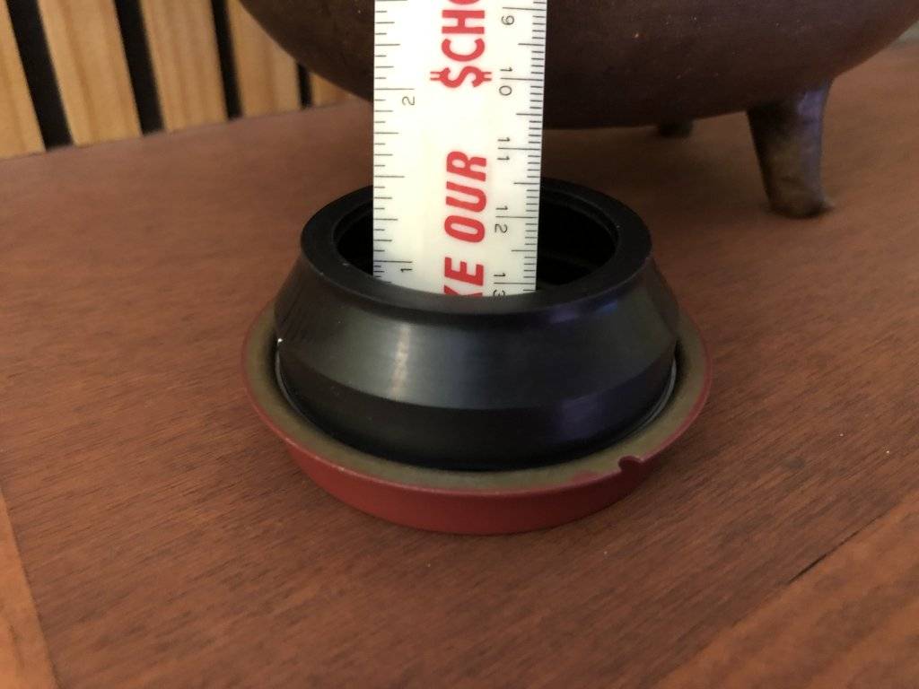

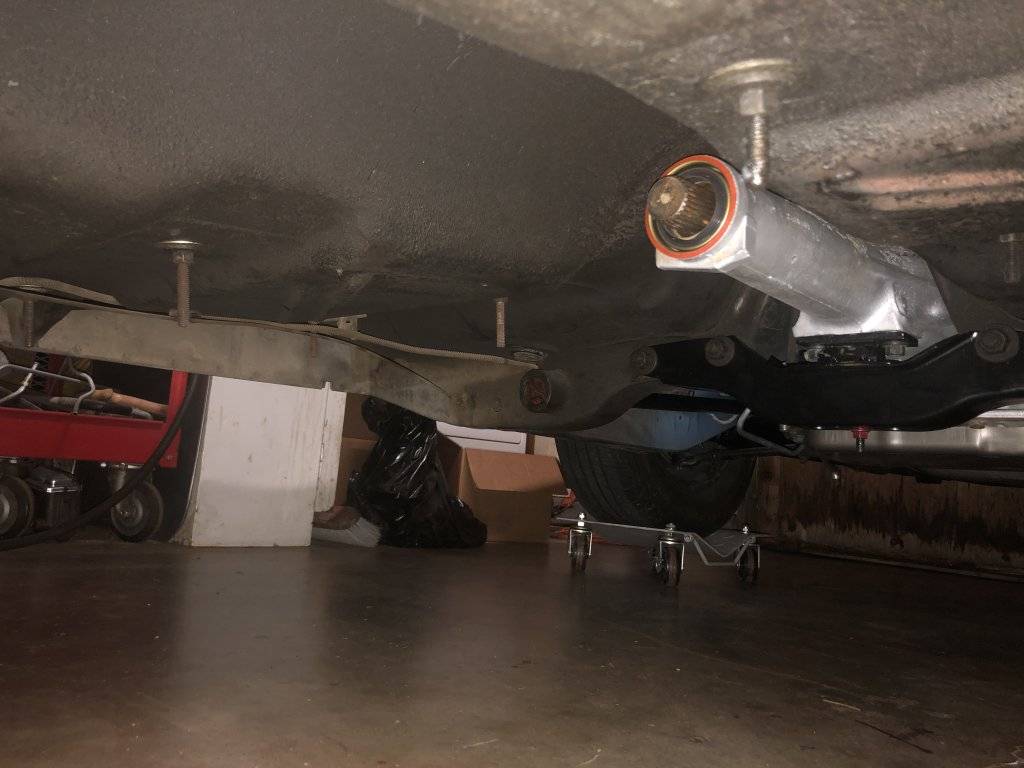

I do see the orange lip of the seal. I'll have to get a better look when I jack it up next to confirm where the leak is coming from. It does leak quite a bit when I have the front jacked up.
I went back to the shop that did the rebuild to address another leak that was coming from the pan last week. I told about the leak and he said that there is some plug up top that gets worn over time and I could just put some sealant on it. He didn't seem to concern about it‍. Should I be more concerned? It does not seem to be leaking when the car is on the ground.
