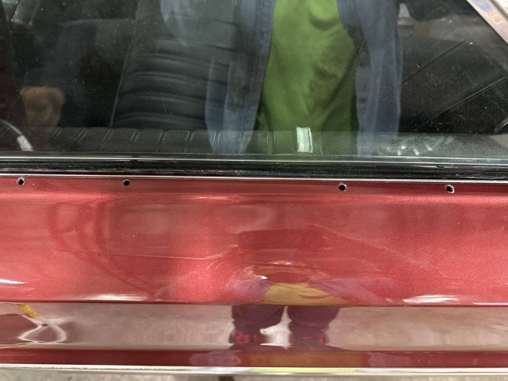

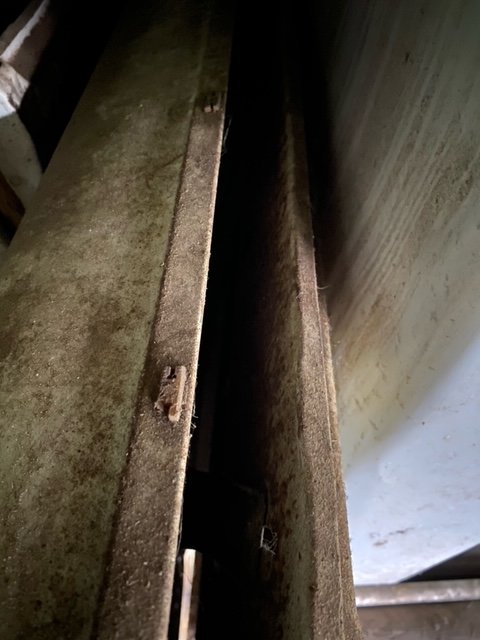

Looking for trim clips for my 65 Sport Fury. Trying to put the small trim at the bottom of the windows back on and have no idea what to use ? Included a picture of where the trim goes. Any suggestions on what to use will be greatly appreciated!
No it’s the trim on the outside of the car. Here is a picture of where it goes and the hole for the clips

Those plastic clips with the center pin are not used for belt moldings.

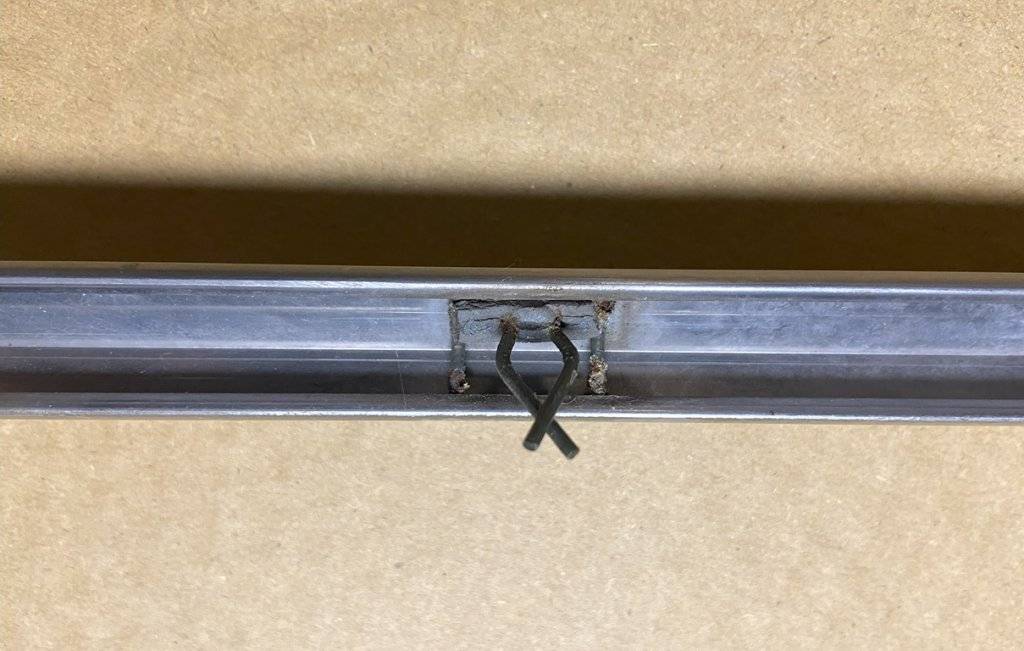

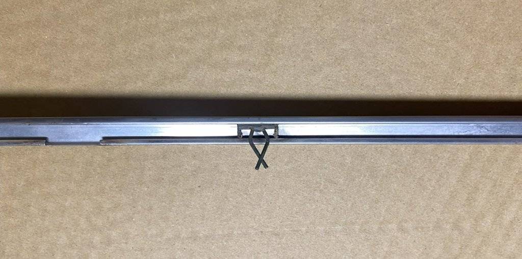

Here's an original door belt molding and clip from a 1967 Dart. Would expect that the trim clips used on 1965 moldings are of a similar spring wire design.
Mopar used many of these spring wire clips in various sizes just have to find the one with correct dimension to slide into the backside of the 65 Fury molding.

Thank you. I saw these on a web site but was not sure they were for this type of trim. Will order them and see .
