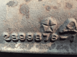

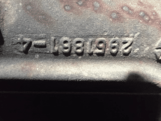

Sorry to bother you again, I just got a call from tti the manifold numbers that you supplied work but they don't unfortunately show a pipe that connects from the manifolds to the system. They told me that you can have a exhaust shop to make those pipes when the installation is done. Or we would have to change the manifolds to different castings. But that is a lot of work. Let me know how you would like me to proceed
So this got my attention and although Im still planning ona dual set up It seems it will all have to be custom. The manifolds although legit, are apparently "rare" and dont have a pipe set up to marry up to them...so then they tried to sell me headers...
The Email I wasn't waiting for....
View attachment 70382View attachment 70383
When I got mine, they also sent a note that the passenger side manifold was one they did not have a part for, but sent along an additional short piece. It was a flange with about 6" of pipe. The front pipe flange was not clocked right for my manifold. Easy fix for my guy, only about 15 minutes work.
