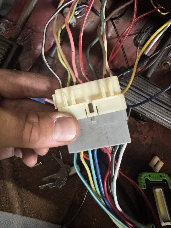

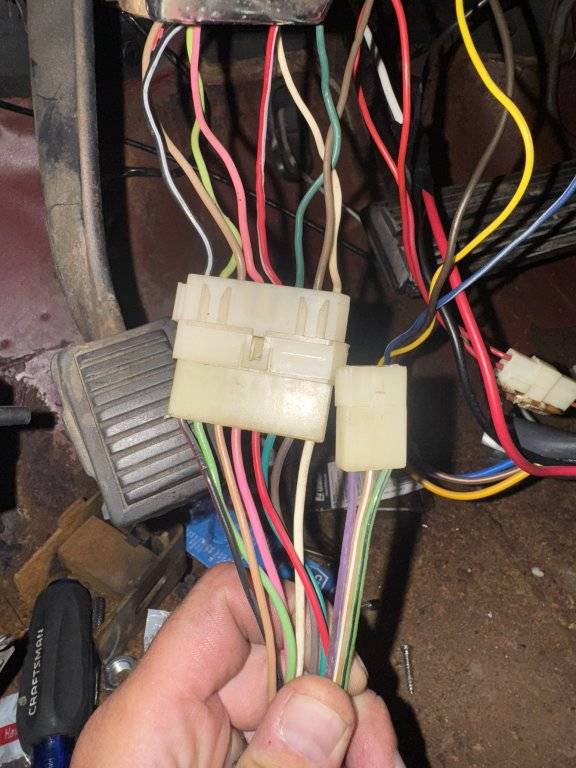

On to another wiring issue with my 70 Plymouth Fury III. You all helped me out so much on the headlights, so hoping for some more help on this.
When I bought the car I was told the switch was bad. I purchased a new switch, off ebay, and having issues. The new switch i bought does not have the same color wiring so I am wondering if that could be part of the issue. Also, the switch I took out had 2 plugs...I will attach photos. The new switch only has one. Can someone tell me what the small plug on the old switch would go to? I do not have a tilting wheel, just basic. When I use the old switch I get the flashers to work, but when I use a turn signal, the flashers come on. Thank you again for the help in advance!
