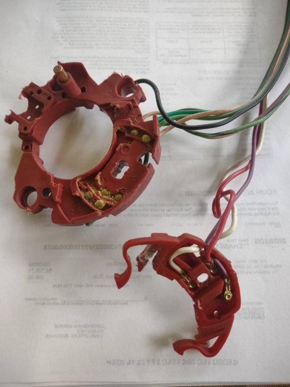

Does anyone know if there is the top part of a signal switch that will work on a 69 chrysler 300 saginaw with tilt,tele. Only the part with the catches is broke and it separates from the main switch easily once you pull the tilt arm out.
I found the two wire top piece at classic industries and it has the mounting hole for the 3rd wire. It was $10 so no problem if it wont work.
The manufacturer of these cams is Shee-Mar. Their calatog lists the SM-15 as the correct replacement, but it only has two wires.
The third (purple) wire is for cornering lights, so SM-15 is only for cars without cornering lights.
Unfortunately, Shee-Mar doesn't list turn signal cams for cars with cornering lights.
But you could try and contact them. Maybe they have or even will make them.
From the Catalog:
C-BODY
(Full size - Fury, Imperial, Monaco, New Yorker, 300, Newport, Polara, Town & Country, etc.)
69 - 67
w/tilt & telescopic wheel
Switch = SM107T
Cam =SM-15
w/o tilt & telescopic wheel
Chrysler design (white)
Switch = SM106
Cam = May take either a SM-9, SM-13, or SM-16 depending on previous replacement of switch.
Saginaw built (reddish)
Switch = SM107
Cam = SM-15
