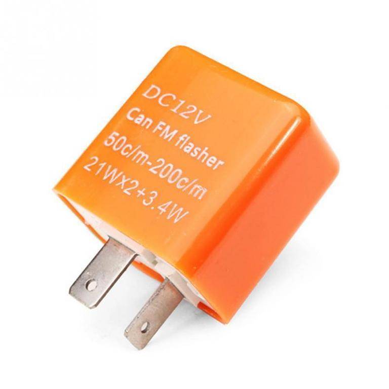

Thats good information, thanks. I didn't know if the fluctuation in flasher frequency was a fault or not. I'm wondering if it's possible to put a more modern component in there that always pulses at the same speed regardless of voltage changes. First I need to find it though! :)
Sounds interesting! However, despite claiming not to be affected by varying loads, the specifications on the housing state "two bulbs".
Other specifications given also do not indicate if it can actually handle the load of three bulbs flashing simultaneously (one in front, two in rear).
Finally got around to looking for the flasher today and thanks to all your input I found it after a few minutes, tucked up under the dash on the left side of the steering column. Not what you'd call "visible" but I suppose that's ok if you only have to change it every 50 years! :)
And thanks to the electronic flasher recommendation from @ceebuddy she now flashes nice and steady, regardless of engine speed or lights on or off. :)
