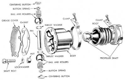

Is yours bad they are kind of like the inner c.v. joint on a front drive car if the boot is not ripped for a long period (contaminating the grease ) they usually don't go bad, or lots of abuse. Sure you can't just clean and regrease with new boot only.
Not sure if its bad, I know the boot is ripped. I will be taking the tranny out soon so I figure I should replace or repair since I have to pull it apart.
