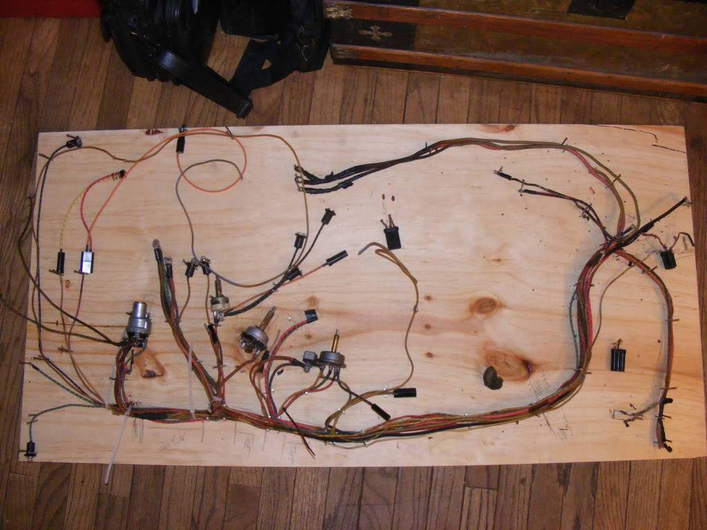

What I've done with other cars is lay the existing wiring out on a piece of plywood and laid out the "pattern" with headless finishing nails. Then unwrap and change one wire at a time and rewrap it with harness tape (has no adhesive) Rhode Island Wiring Service Inc. has a lot of the terminals and good wire sold by the foot. For that matter, I think if you sent them a harness they could copy it.
Here's a pic of how I do my harnesses. This is the exact same way they make harnesses for aircraft etc. I have seen it in person in defense factories.

That particular harness was for a '53 Chrysler, so there wasn't a bulkhead connector like we have in 60's-70's cars.
If I was doing one for a later car, I would use the bulkhead connector. IMHO, the bulkhead connector doesn't cause any problems as long as the connectors are clean and tight and you aren't trying to overload any of the circuits.
Really, the only connector I see having big problems is the connector under the steering column after they went to the ignition key on the column. The red feed wire always seems to be burnt and melted.
