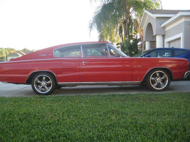

can't say I agree with that. 17x7 front, 17x8 back. They replaced the 14" wheels road wheels the car had. I have the same size for my 65 Sport Fury (when ever it gets done).
