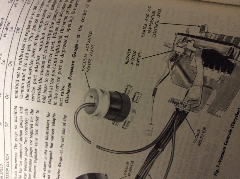

Noticed this leaking (very slowly) on my 300 the other day you can tell there is water escaping from the calcium build up.
I checked with O' Reilly they had never heard of the part. The hoses are old and need to be replaced, but I was wondering if this vacuum actuated water valve has a gasket or can be rebuilt or if the whole problem stems from old heater tube lines an poor clamps to seal them off.
Pics attached

Those OEM bakelight water valves are known for their fragility and cracking and warping. They are pretty must toast once they start leaking. You can still find NOS ones for under $100, or you can go with an aftermarket metal unit that will probably last you a lifetime.

These valves came on a/c cars only as Alan states, and the original bakelite housings are prone to cracking in about 2 years of occasional use. They are just junk. I have no idea how any durability testing of those original valves could have ever allowed them to be approved for production. While the metal ones do not look original, they will work for a long time.

The original valves are occasionally found on ebay still, but they are pricey, somewhere just a little south of $100, and for a couple years of use, it hardly seems worth it. Go with the metal valve and then you can forget about it.
