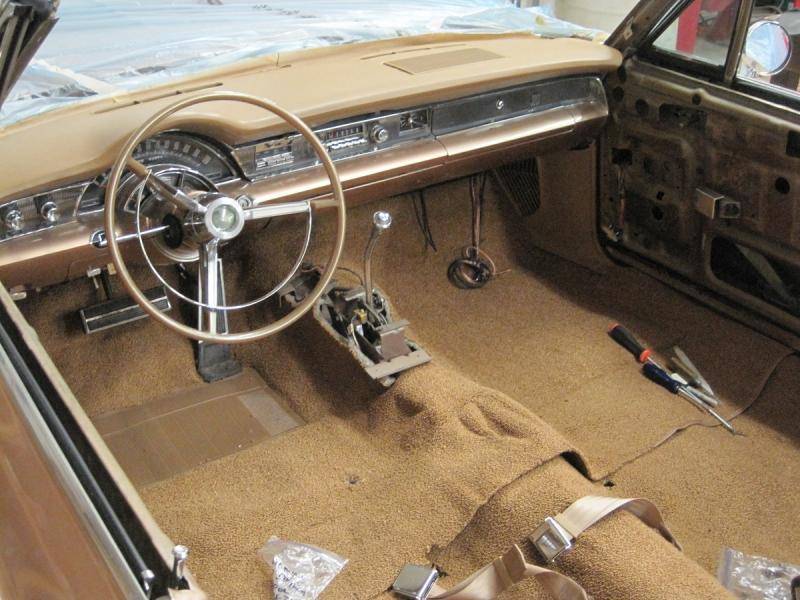

x3 on SEM Dyed the dash and all other plastics in the car. By far the closest color to original, very happy. The back panel was actually a replacement out of a blue 300. Matched perfect with everything else.
