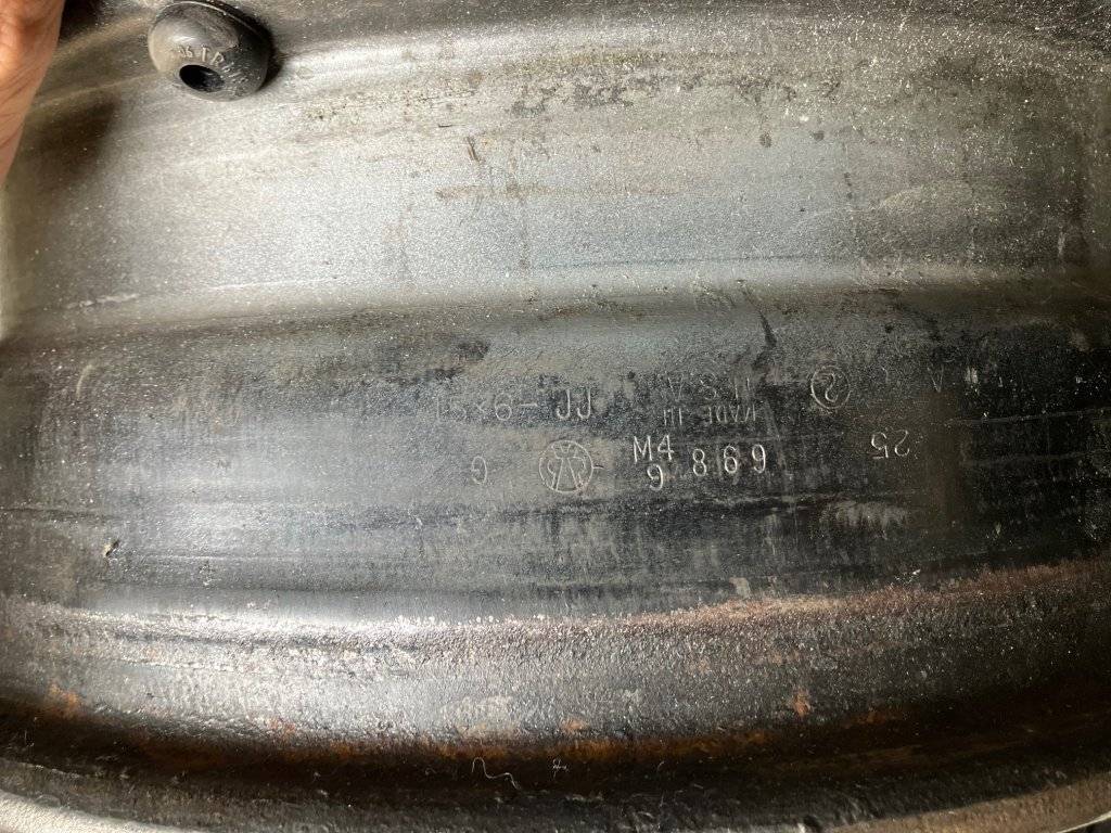

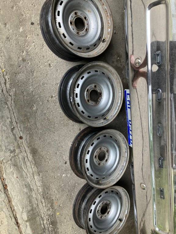

Bought a set of non chrome road wheels with the early tall center caps and splined end caps.Is 3461061 a 1970 only wheel? Can someone decode the stampings and date codefrom the pic?
Could someone tell me what these stampings mean?

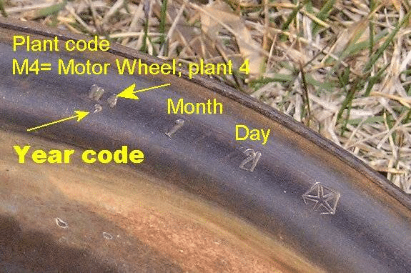

Based on the above the year code is 9. 1979 does not match your center caps.

Looks like you have it covered. My only input is the 869 might be the date code of August 1969 but I don't know that for sure.
The "9" stamped into the inside of the rim indicated 1969, and only 1969 in this case. What are the stamping to the right and left of the valve stem hole(maybe you can provide a picture or two)? Are they the same for all four rims?? If they are not stamped there, then look in the inside lip of each rim for the codes, as provided by 1970FuryConv. They are not typically stamped there, but I have seen them especially on 14x5.5 Road wheels and the odd rallye wheel, also 14x5.5.
they are all the same with 3461061 by the valve stem hole only.I was thinking maybe the 25 and G stamped on the inside of rim were for 25th of August?
No that has nothing to do with the date. Those stampings are on the inside of each rim lip, probably on the opposite side from where the valve stem hole is. You need to find them. Having a matched set of four is much more valuable than four random dated ones. Do they all have the same M4 with a 9 under that, on each rim?
they all have the M4 with 9 under but will have to look for the date on the inside rim lip
