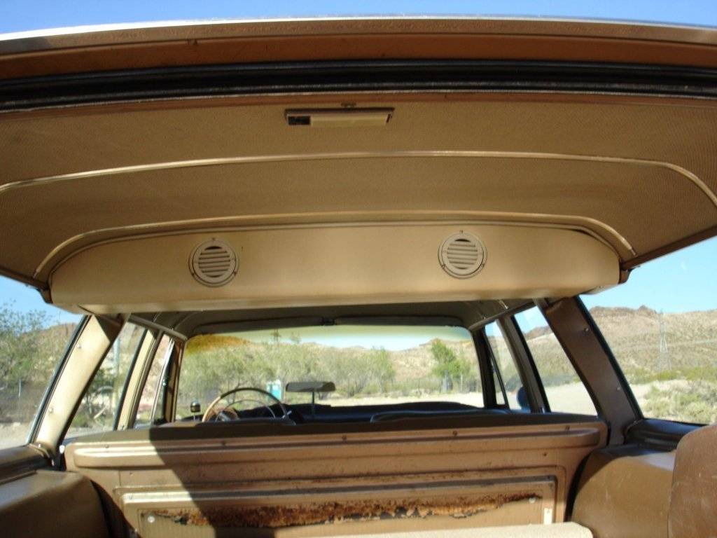

How much do you have to restore? My headliner and visors are also pretty nice except for a small hole in the wayback. If you need any reference photos let me know.
Thanks for your replies! The front half is in good enough shape to leave as is. The back half is sagging a bit. The front bows are fine, one of the back bows is broken, hence the sagging. I’ve read about some conversion headliners, obviously not using hardboard. Has anyone checked those out? I probably will just bandaid the rear as best I can and keep the originality there.
ally found a manufacture for the pressboard headliners for my wagon. After a long afternoon with google I found a reference to a company called R.E.M in Annville, PA, they manufacture restoration parts for various cars. I emailed them to inquire about the pressboard headliners they have for other vehicles to see if I could buy a sheet. Mike Miller responded to my request and said if I sent him a template he would cut them to fit. They showed up today and look great. I will post an update as soon as I get a chance to get them installed and report on fit (and my template making skills). The holes for the visor mounts and dome light are nice clean cuts. Here are the finished sections and a sample of the material. Hope this helps others replace this elusive part.
