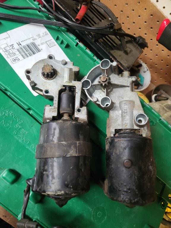

69 to 71 Plymouth Dodge and Chrysler are all the same then 68 to 70 B body wagon's the motor is the same you just have to swap the top gear piece.
Here's a picture C body wagon motor on the left B body on the right. I have 5 or 6 working motors if interested shot me a message I'd sell one.

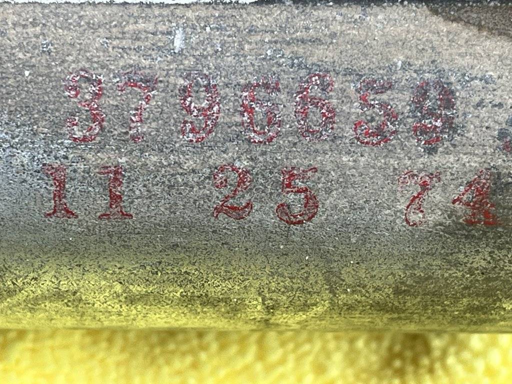

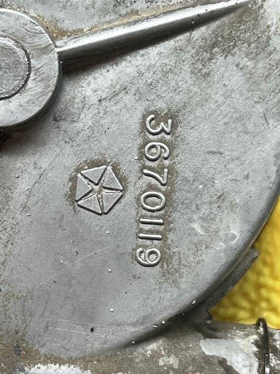

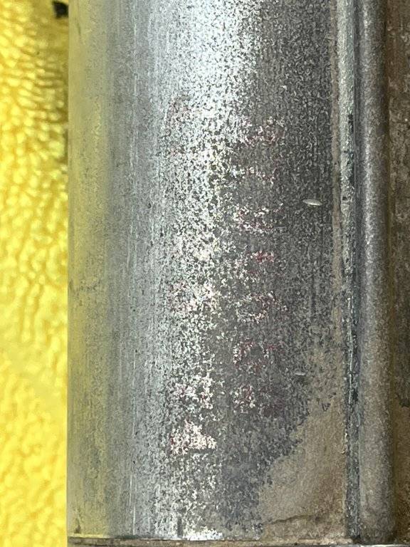

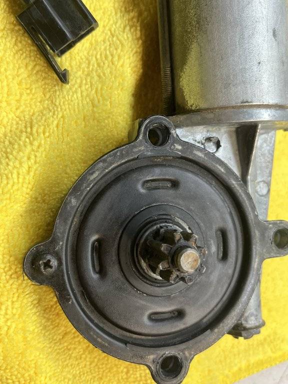

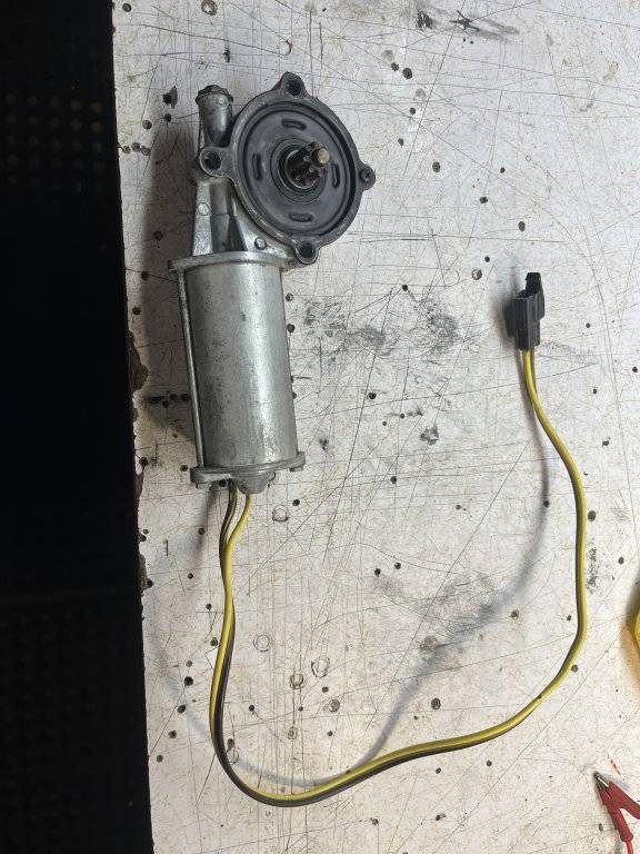

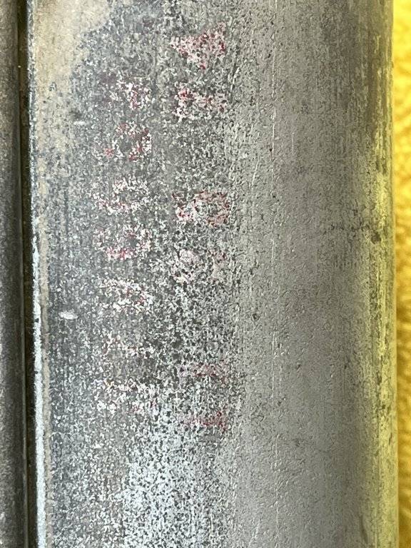

I have this one sitting on my shelf in the garage. I pulled it from a Chrysler Station wagon a couple years ago . It works great. PN #3670119 The car it came from looked a lot like yours, It was a fuselage. I removed the power vent windows from it while I was at it. If you think this is something you can use PM me .
