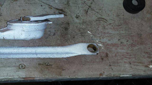

I have one in particular what looks like a nylon bushing is hogged right out.
I can't seem to locate very easily replacemnt bushings for the wiper linkage.
Rock Auto doesn't mention them.
Help on this is appreciated!

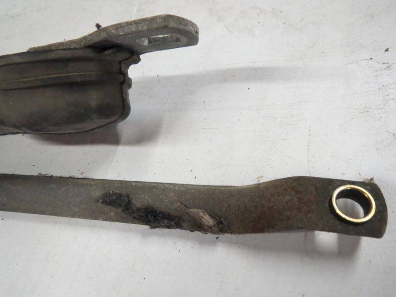

There is a package you can buy from Advance Auto i have gotten in the past, it carries a range of ford, chevy and mopar in it and i managed to get the right ones in that for my car but is a 1970 so not sure how far back it will go
Here you go.. it's best I have at this time

Hmm, I think you need an earlier model style i will have to let someone else comment on this.
Here's one from '68 Chrysler and my parts book shows it to be the same for all C-bodies. It has a part # 2496125, what does yours say on it?
I just found that number on the linkage itself..
Right in the middle.
What part # is on the other arm? I have a feeling it'll be different than the one I have but I'd sell the whole trans to you for $40 + shipping.
You can still get them from Chrysler. Tell them have have a Ram van. I don't remember if I told them 1995 or 2005. They were $5-6 a piece but well worth it.
I got a set for my '76 T&C on eBay. Maybe 10 bucks. 9/16 diameter. But good luck with finding some for a '78 NYB...I'm still looking. 5 years now. You have to buy the whole transmission to get the bushings. For some unknown reason, hidden wipers, with intermittent uses an entirely different bushing and transmission system than even my '76 T&C that has hidden wipers with 3 speed. Go figure
