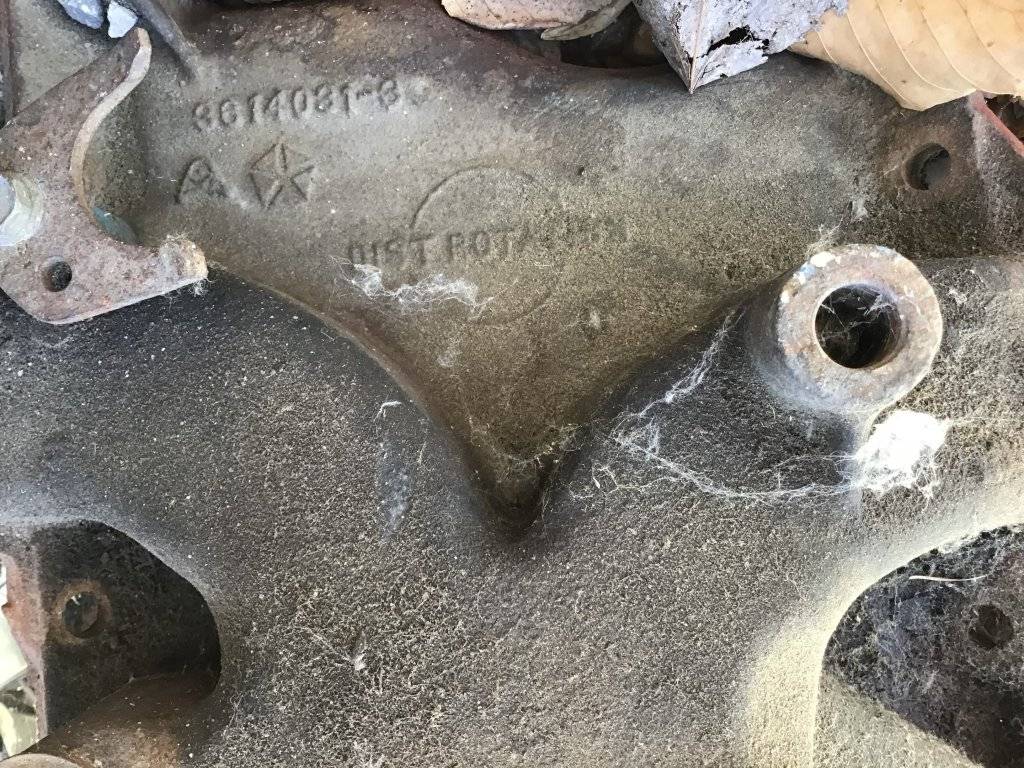

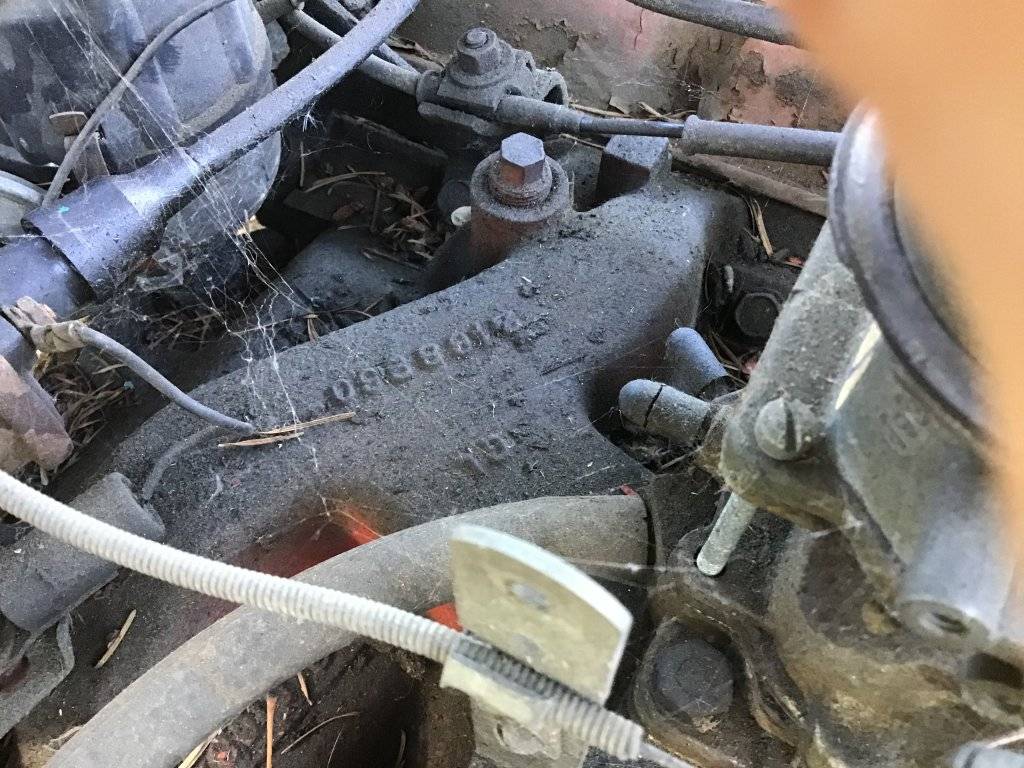

CBODY67
1967 and 1969 have duial planes, top photo of the 1969.
1970-71 is single plane, lower photo
Thanks for the photos. I can't quite make out the PN on the top manifold, but it does look like what I have. I note in that photo:
- capacitor on coil primary side
- brake booster vac port is plugged (so no power brakes?)
- extra vac ports on carb (if this is BBD carb, I didn't think it had those until later years).
- no choke? Or is that some sort of manual choke linkage?
