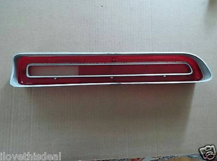

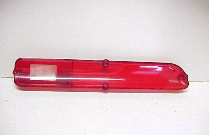

Unrelated - how are your lenses? I have two extra sets of '70 tail light lenses. I don't need them. let me know if you do.
I may be interested. I have one that is cracked. Mine also have the metal louvers. I can take a pic this evening to see if they are the same.
That's quite different from the ones for a '70. I thought they were the same. I'd show you a pic of mine except I don't have any picture files on this new computer.
