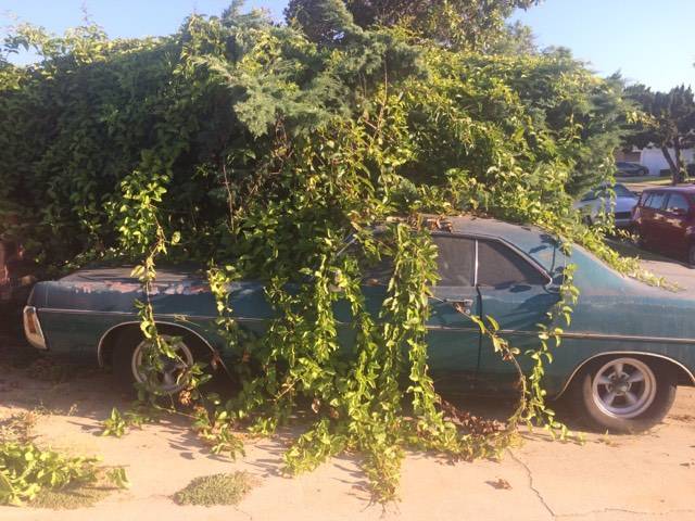

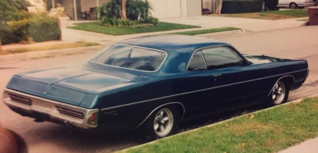

My 1971 Dodge Polara custom 2 door Hardtop. I've owned it for 33 years now, bought it from the Original owners in 1989 for $450. I was their Mailman for over 20 years.

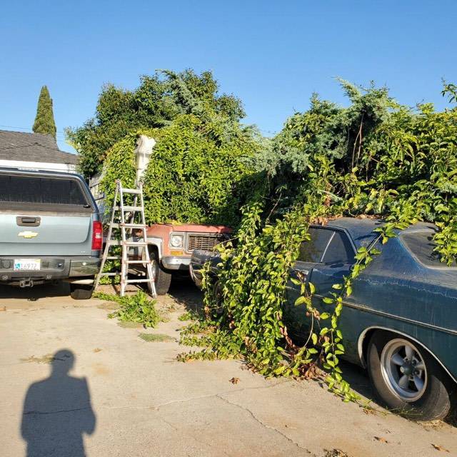

After 10-12 years sitting with the Green Monster eating it, I had to rescue it and send it to get a Rebuilt Trans and lots of other work done to it to get it back to turn key ready.

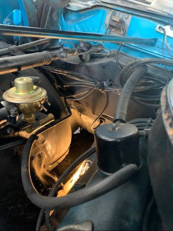

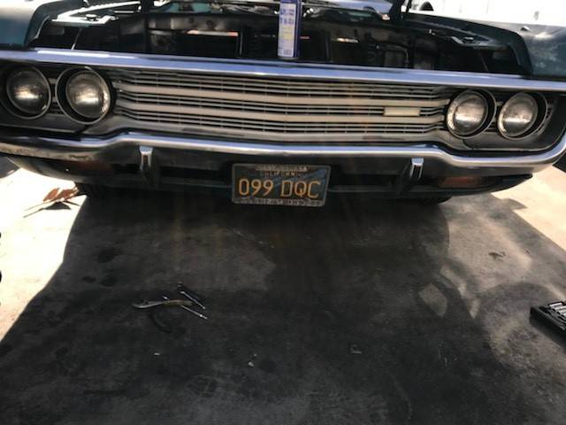

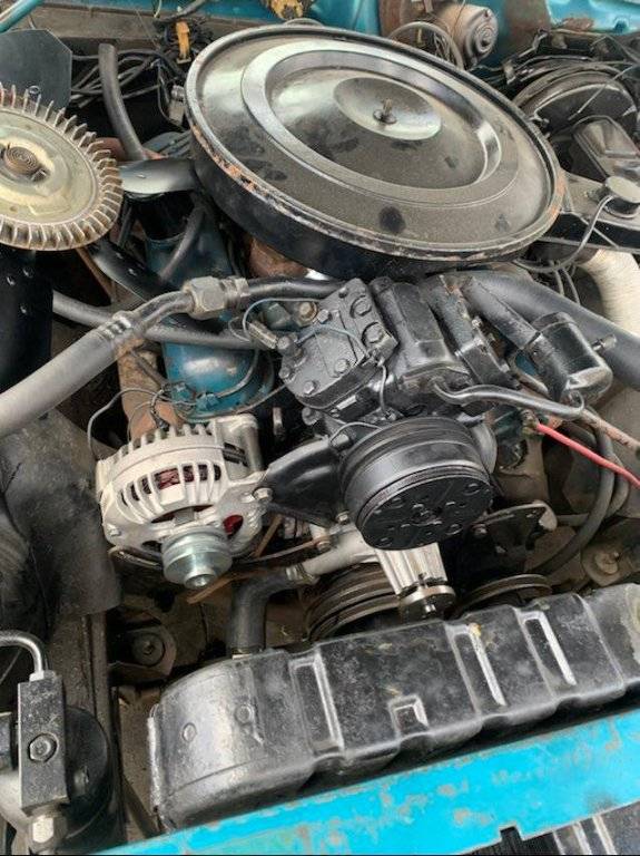

It's still in the shop getting things done so it will be turn-key when it's ready. The A/C unit was sent out as the clutches had froze up. They said the housing was Cracked (I wanna see that) and had to replace it. Back on the Car now waiting to put on New Belts. You can see the New Alternator, Water Pump and in the next pic the Heater Control Valve.

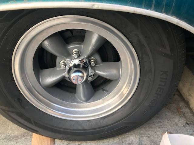

Man things got expensive when we weren't looking. Back in the day 1989 when I bought the car from original owners the Heater Control Valve was like $10-$12 but now E-Bay fine for $89 + Tax + Shipping $109.00 but ya gotta have it. Carb was Rebuilt $350 Brakes front and rear done, new Brake lines and 6 little 12 inch long Gas lines by the Tank, New Tires (old ones had tons of tread but 22 years old and they wouldn't reinstall them.) Had the American Torq Thrusts cleaned and polished up, bought new center caps and lug nutz. New grill installed. Carpet, Headliner and seats done just before it was parked, so should be good to Go!

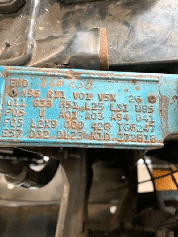

Going back to your Polara, I see from the fender tag that you posted here that DL23K1D272818 was originally FQ5 turquoise metallic ("Poly"). Was it repainted at some point in its life?

Here is a decode of your tag:
E57: 360 cid 2 barrel V8 255hp
D32: Heavy Duty Automatic Transmission
DL: Dodge Polara Custom
27: 2-door hardtop
K: 360 cid 2 barrel V8 255hp
1: 1971 Model Year
D: Belvidere, IL (Plant)
272818: Sequence Number
FQ5: Turquoise Poly Exterior Color
L2X9: Trim - Low, Cloth & Vinyl Front Bench Seat, Black
000: Full Door Panels
428: Build Date: April 28
T66247: Order number (T VON = C.L.C. LEASE CAR/DIRECT LEASING)
FQ5: Turquoise Poly Top Color (no vinyl top!)
U: USA Specifications
A01: Light Package
A03: Deluxe Light package (Map/courtesy light, Ignition switch lamp with timer, headlamp switch lamp with timer, Fender turn signal lights, Lock doors lamp, Low fuel warning lamp)
A94: Reminder Light Package
B41: Power Front Disc Brakes
G11: Tinted Windows (All)
G33: LH Remote Racing Mirror
H51: Air Conditioning with Heater
L25: Trunk Lamp
L31: Hood/Fender Mounted Turn Signals
M85: Front & Rear Bumper Guards
N95: NOX Exhaust - Emissions (meets California standards)
R11: AM Radio
V01: Mono Tone Paint Treatment
V5X: Body Side Stripes, Black
26: 26in Radiator
END: End of Sales Codes
