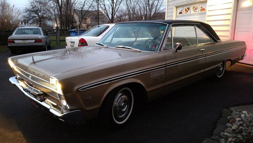

Thanks for the welcome! I've got a 65 Fury III with the 318 poly that my grandfather bought new in 1965, he died in 1971. Car mostly sat til my grandmother died in 1988. I've had it since then...has a little over 40,000 miles! I've just done a COMPLETE suspension/brake/fuel system rebuild and added front and rear sway bars that transform the handling. Now I find I'm looking for a little more power to match the newfound sporty suspension. I'm trying to put a 4bbl intake and carb on it. The problem seems to be that the linkage is different for my current 2bbl stromberg. As it is now, the 2bbl linkage "pulls" to increase rpm but the 4bbl carb seems to need a "push" to increase rpm...I absolutely want to retain the original linkage setup and seem to need to pick a different carb to accomplish this. Maybe I have the wrong carb?? I have an intake with part # 2206384, and an NOS AFB carb # AO3131S. I Think I've heard of people using an edelbrock 1406 or 1806 AVS 650 cfm...what say ye?...
Thanks.
J.G.
Hello from Minnesota. Edelbrock 1406 works great, but the linkage needs to be modified. Someone should have a picture.
