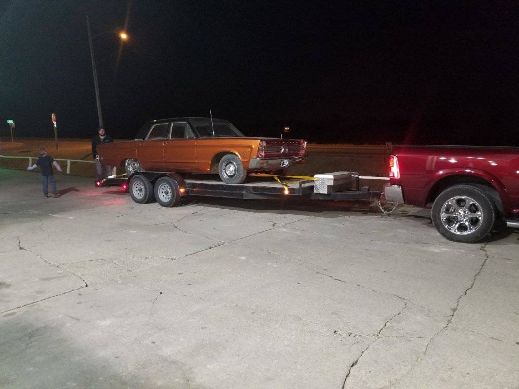

here is the 66 Fury I that we got. I need to find seat covers and a carpet kit and a driver side window channel felt so the window stops rattling. it needs little things. it' a 318 auto.

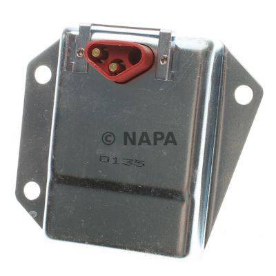

thanks everyone. finally got it to actually run. I put a new alternator on it and it's charging at 17volts coming out of the alternator. but when I check voltage at the battery when it' running it' 14.6. does this sound normal to everyone? I'm not used to this style of alternator. I used to internally regulated alternators on my vws. thanks again
thanks at the battery? can anyone tell me if it's internally regulated or does it have a separate regulator?
Separate, it looks like this;
Cheap and easy to replace, it's on the firewall, passenger side of the wiper motor.
