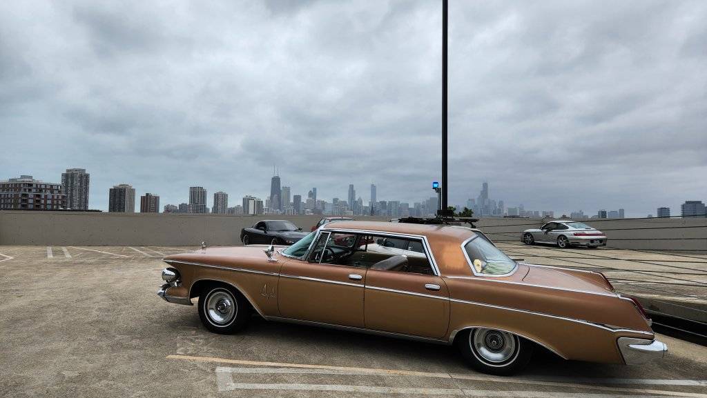

This summer, I finally reached the point in life where it became possible. I found a 1963 Imperial Custom with what I believe to be only about 60,000 miles for sale by a long-term owner. It's not perfect, but it's incredibly solid, complete, and (so far) a reliable driver, which is exactly what I wanted. Don't worry, this car will never go near a derby, but I live in a big city, and I wanted a car I could enjoy and use without worrying too much about wear and tear. The paint isn't original, but the body is solid, and the car is remarkably complete. I've even found 1963 date stamps on the carb and alternator! As a Custom, the car has almost no options, just a passenger mirror and Mopar under-dash AC that looks like it was dealer installed in the 60s.
