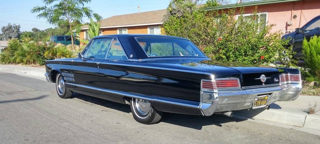

Except for the obligatory photo of how she sits right now.
Flucking beautiful! I would gladly do anything that car needed me to do if I owned it. Keep up the great work and don't stop with the pics, oh and welcome back to the site from the Motor City!

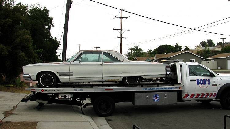

Here are a before and after, Day1, the day I got it to the house about 4 yrs. ago.

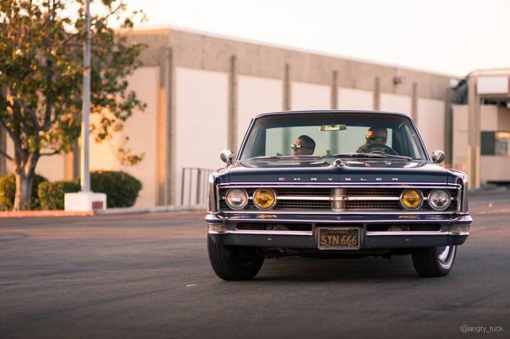

Except for the obligatory photo of how she sits right now.View attachment 95637
Mighty fine looking '66 ya got there. Welcome back.

Here are a before and after, Day1, the day I got it to the house about 4 yrs. ago.View attachment 95650 View attachment 95651
It only took you 4 years?!? That puts you in the "You suck list" for sure! Sweet looking ride, wow what a difference. I love the yellow in board lights, too.

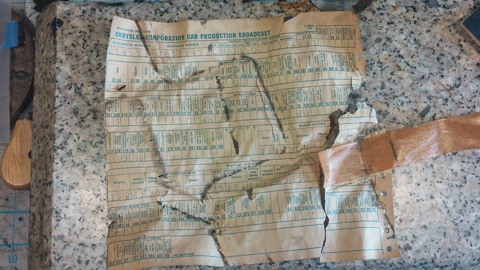

I had heard that these can sometimes be found in the springs on the back seat, yup that's where I found it. It was pretty brittle but I was careful when I removed it and I was able to save most of it by giving it a very-very light misting of water out of a spray bottle. Now I'm looking for the right frame so I can hang it in my shop.
Make a color copy of the build sheet and store it in an acid-free clear plastic folder, and keep it out of the light. Hang the copy in the shop.
Well done, I'm four years in and no end in sight. More photo's when you can.
