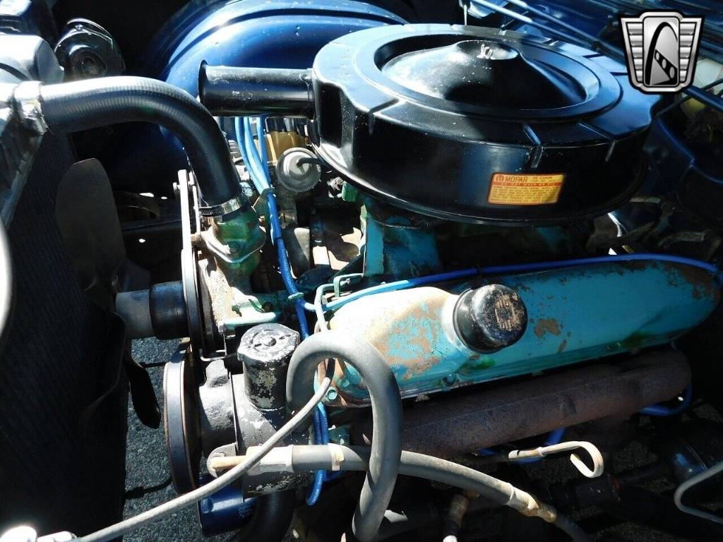

Anybody seen this air cleaner before and know what it belongs to?

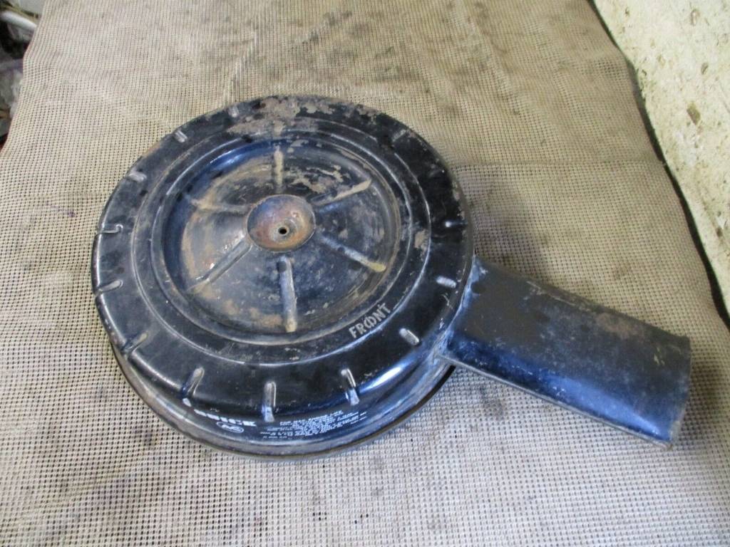

I've never seen one of these 63-66 non-piepan cake-pan air cleaners with the ribs in the center section. (62-earlier std-performance air cleaner was smaller dia and had none of the OD ribs - it's totally different)
The shape around the wingnut isn't even the same as the 'normal' air cleaner, it's flatter, and isn't as tall.
But the grooves near the OD, the snorkel, the indentation just CCW of the snorkel - are all Chrysler.
Quite curiously, it does seem to have an extra groove vs the the same spot in the 2nd pic, so it's obviously a different stamping tool (in addition to the other changes).
Anyone know?
It doesn't hold any info, but here's the link to the whole car...
1963 Chrysler Newport | eBay

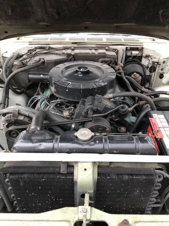

Interesting. Initially, I thought it was a proper air cleaner, just clocked wrong. Pre-1966 air cleaner, for certain, as that year was the first to have the Cleaner Air Package available, which had the nipple for the crankcase breather hose. In 1966, that was a mandatory California thing. It appears someone had the engine out once upon a time, as Corporate Blue wasn't an engine color in 1963. Therefore, the air cleaner might be from another make...Studebaker or AMC, maybe?

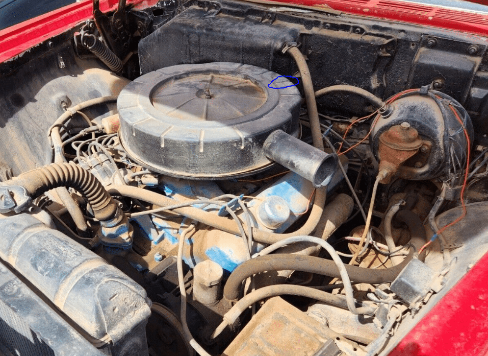

This is the one on my 64 413

And it has way too many Chrysler details in it for aftermarket. Although the blue-circled groove is really strange to see.

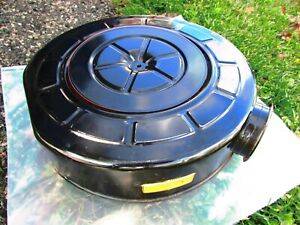

I goog'd 1965 AMC air cleaner and got this, which resembles a late-50s 413 version.

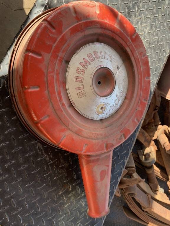

And 64 Olds 330civ 4-barrel:
My first thought was early 60's GM. Looking at the ribs in the center of the top, they are reversed from the GM and the GM air cleaners seem to have oval air horns so I ruled those out.
I think you're going to find it's a Mopar air cleaner... Just figuring out which is going to be the challenge.
Good catch, I didn't notice the GM grooves were scallops and not ridges.
