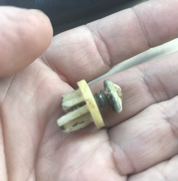

I have a 72 Custom Suburban (Fury) wagon and a 4dr as well. (Also 68 newport). The driver window on the wagon is a mess. Peeking through my mangled door panel I can clearly see the plastic/nylon rivet is gone. A member made reference to clipsandfasteners.com selling bags of 25 but when I called they needed a Chrysler part number. From an eBay listing (2 for 15.00) I got 6023695. They don't carry it.
I suppose I can afford 15 bucks to fix one window but I have two 4doors and a wagon so that's potentially 12 doors..
Does anyone know of a good source?
While I have the panels off, can someone please tell me what other common pieces are good to replace? It looks to me as though some parts will be common between my fuselage and slab cars.

IT sounds like you need the plastic and metal/plastic window retainer. I think 2 door and 4door/wagon used different retainers to keep the glass in the track.
Checked online both of those...search didn't turn up anything ...I'll ring em this week and see..thank you
You asked about typical wear items
That would be
Rollers
Window guide flocking or channel guide rubber
Window sweeps
Possible door seals for the door itself
