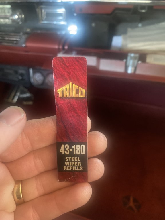

I’m not sure if this will exactly answer your question, but I am using Trico 43–180 on my 66 Newport with original stainless steel wiper arms. I found some on eBay for 20 bucks.

Guys, while looking at the Trico 43-180 refills, I see that OER vends a new rubber replacement for THAT: F309 - Trico-Style Wiper Blade Insert; 18
