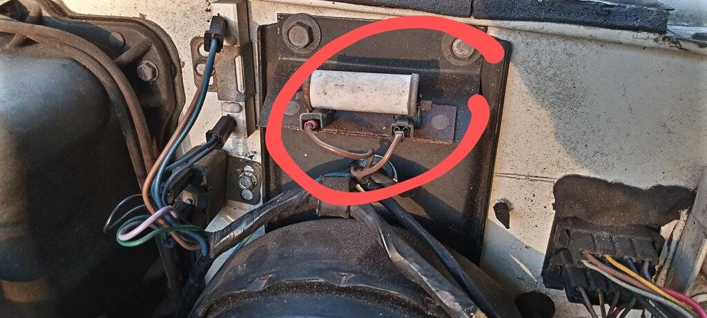

What is this and what does it do
Imperial dude
Jan 25, 2021
171
331
Ohio
1964 imperial, I've asked several of the Mopar guys at the car shows and they're stumped
At first I thought is was some kinda old timey ballast resistor, but then I saw the ballast resistor to the right of it
It basically looks like a spool of white thread
Any idea what it is and what it's for?
Balast resistor only on factory AC cars. Don’t know what it connects to. Look on a wiring diagram.
the one for the ignition is to the left.
Resistor for fan speed for your A/C.
Look on page 24-4 in your FSM and you can see it in the circuit.
