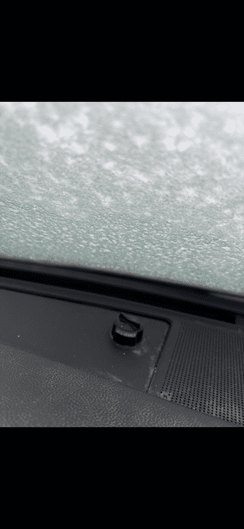

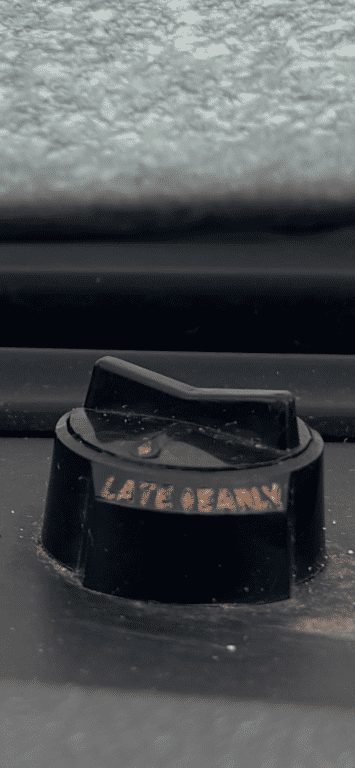

Have this knob by the windshield on a 72 New Yorker what is it for
It’s the dusk to dawn photo-cell for the headlight sentinel system.
So it automatically turns the lights on?
Yes, if the system works it is like todays “automatic” system. Also leaves the headlights on for a minute or 2 after you park it.
You adjust it to have your automatic lights turn on sooner or later at dusk or rising sun. The automatic dimmer is a black box looking out from behind grill on my Imperial.
