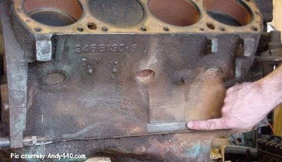

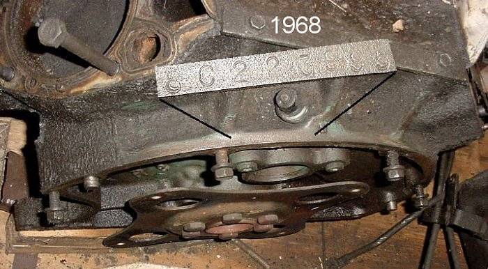

But if we're talking '68 it'll be up on the back near the oil pressure sending unit.

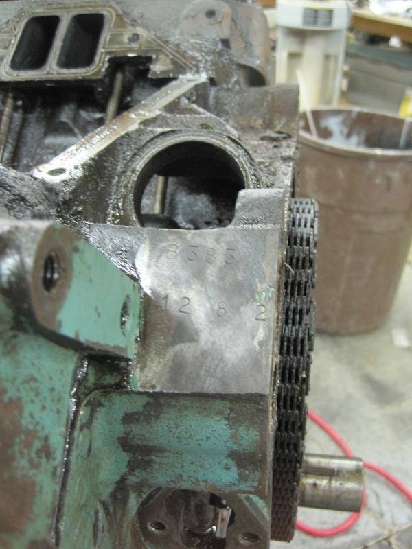

On my '66 it is the front right side, in front of the valve cover. Here is a photo and a decipher for the numbers
According to mine the first line makes since. The last it was made on December 82nd. The 28th doesn't make since either because my Certicard says it was sold on December 25th????
Thanks in advance.
Built December 8th on 2nd shift.
Now I know my build date.
OOPS, guys its a 67, guess you needed that info. And just trying to confirm NUMBERS MATCHING so I can know where to look. Thanks again.
If it's a model year 67, it won't have a VIN.
VINs weren't stamped on the blocks and transmissions until model year 1968.
