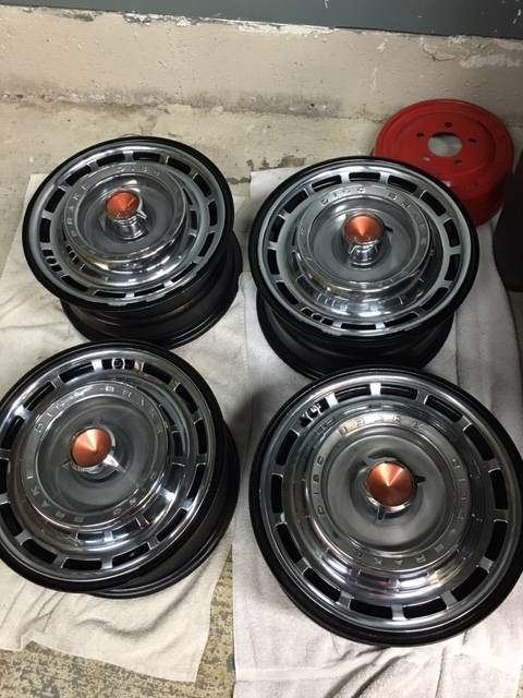

I'm looking to find out what size tires people are putting on the front wheels ( 15 inch ) of a 1966 Plymouth Sport Fury

Are your tires mounted on a Fury or a New YorkerI run 235/75R15 on 6" wide rims.
Any rubbing of your front tiresI have something, something, something 245's on mine.
Did it take any modifications to fit your rear wheels onMine are 225/70-15 on the front and 275/60-15 rear. They are within 1/2" of the same height and I think makes for a pretty good stance.
New YorkerAre your tires mounted on a Fury or a New Yorker
Nope.Any rubbing of your front tires
70 or 75 ratiocop wheels with 235's and 6 turns down on torsion bars, no rubbing
60 series front and rear. 70s would be to tall70 or 75 ratio
