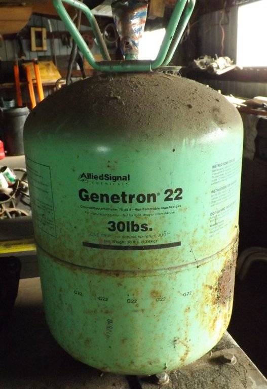

I have had this bottle of gas in the garage since I bought the place and I am wondering what it is for? Any ideas?

It was used in commercial refrigeration units, R22. I believe it has been phased out like the R12 in cars.
This was widely used in commercial freezer units and some heat pumps. It is a "low temp" gas that works well for maintaining freezing temps in large freezer plants. It was also used in transport refrigeration units. Was also widely used in heat pumps in cold climate areas because it was a dense gas that would maintain enough volume for the unit to keep operating when ambient temps got below freezing. Most R-12 systems would shut down at about 10 degrees below freezing. If your house has a heat pump, someone may have bought it "just in case" so they would have it if the system ever needed a recharge. R-22 has now been phased out.

The containers were shipped with 30lbs of gas in them, The empty weighs about 3-3.5 lbs, depending on when it was made. You can weigh the container to determine the amount of gas left. The old school way to charge a system was to place the container on a small scales and install gas into the system until the proper amount of gas was put in. This was on systems that had been evacuated first.

That's cool, the bottle is pretty heavy and the nozzle is still covered in a plastic sheath with the manufacturers name on it, i am thinking it is a full bottle or close to it. I have an old AC system connected to the second house here that I am thinking of selling, 35 000 BTU's. Still pumps air and both motors operate, though the cooling isn't much chop. Probably needs a gas top up. I was hoping this bottle of gas could do it.

I checked, mine weighs 15lbs all up, so it is definitely partially used.
