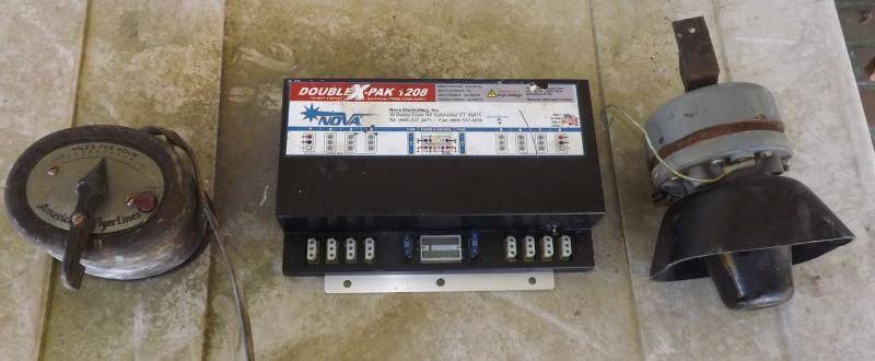

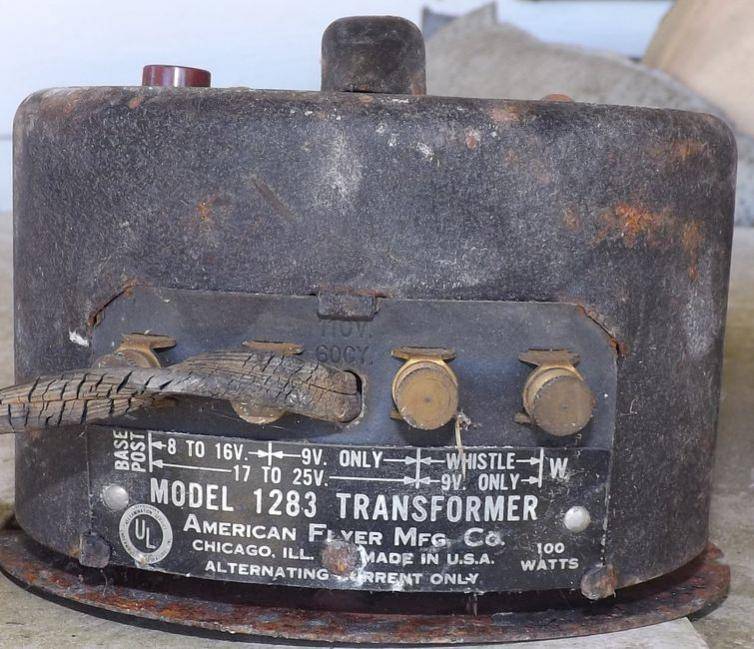

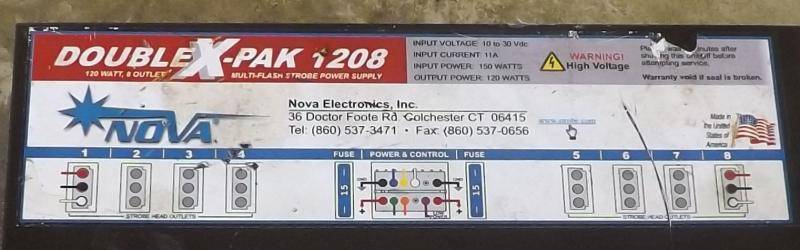

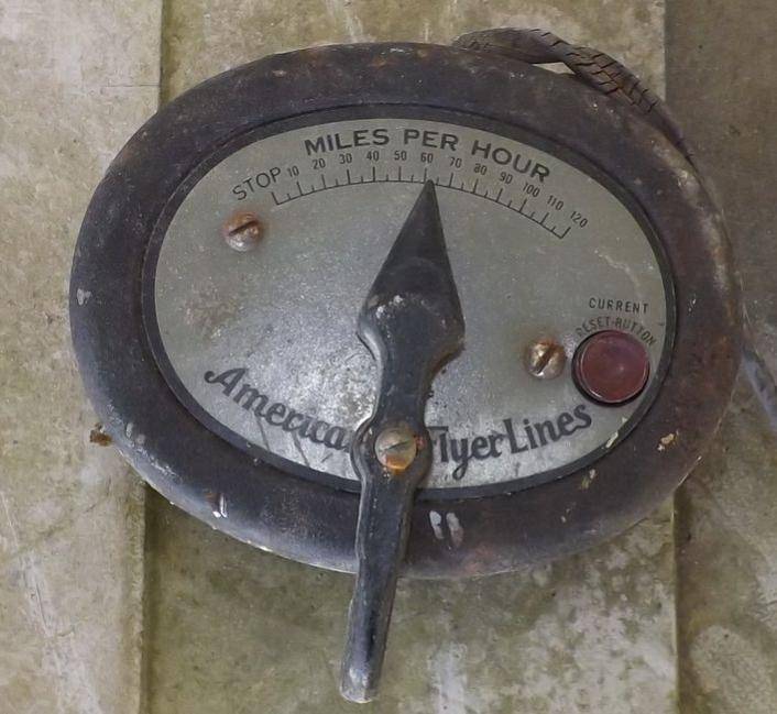

So I found these parts together the other day and I am wondering what some of them are, the siren is obvious, but the other two, a bit more mysterious. The rectangular box has "Mulitflash strobe Power supply" on it and input voltage of 10 to 30 volts. The switch unit "American Flyer Lines" with a voltage input range of 8 to 25 volts.
Anybody got any ideas?
Thanks for tht Stan, I will let the owner know. As for the box, turns out its a police unit, heavy duty light flasher. That's handy, and the siren too.
Please don't plug that American flyer transformer in!! Unless of course you like that shocking sensation of 110 volts....

The 68 year old insulation on that cord often decays between the two wires. Plug it in and enough resistance is generated to melt it the rest of the way. The user won't realize it until they go to move the throttle. The Metal throttle. I get a lot of people asking me to check out the trains they just inherited from grandpa. First thing I do is tug on the cord, 9 out of ten it comes apart exposing bare wire. Hey, I've got 60 year old transformers that operate like the day they were made, but once that cord goes, all bets are off.

The other item to the right is a 12 volt police car siren. It is newer electronic model. You would need a siren control head to make it work properly. Most of the time they rust internally.

Gotta be pretty easy to replace that cord....
The guy said he checked it on a battery and it works, so it should be good i guess.
I been zapped a few times before, but yeah I wont be plugging it in, I saw the frayed coating and said, nope.
