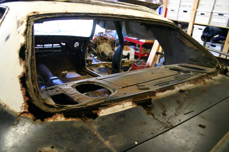

What Commando said.....and definitely keep your eyes open for rust around that rear window, outside as well as inside. That's an ominous sign of big trouble depending on how extensive it is. Sounds like your probably already aware of that area. Ya really have to love these cars to put up with some of the idiosyncrasies about them.
And don't get sucked up in the "California Car" hype, they all rust.

RUST !!!!!! and painted covered rust ............ ( Not my car ! ) phew ,,:app:
