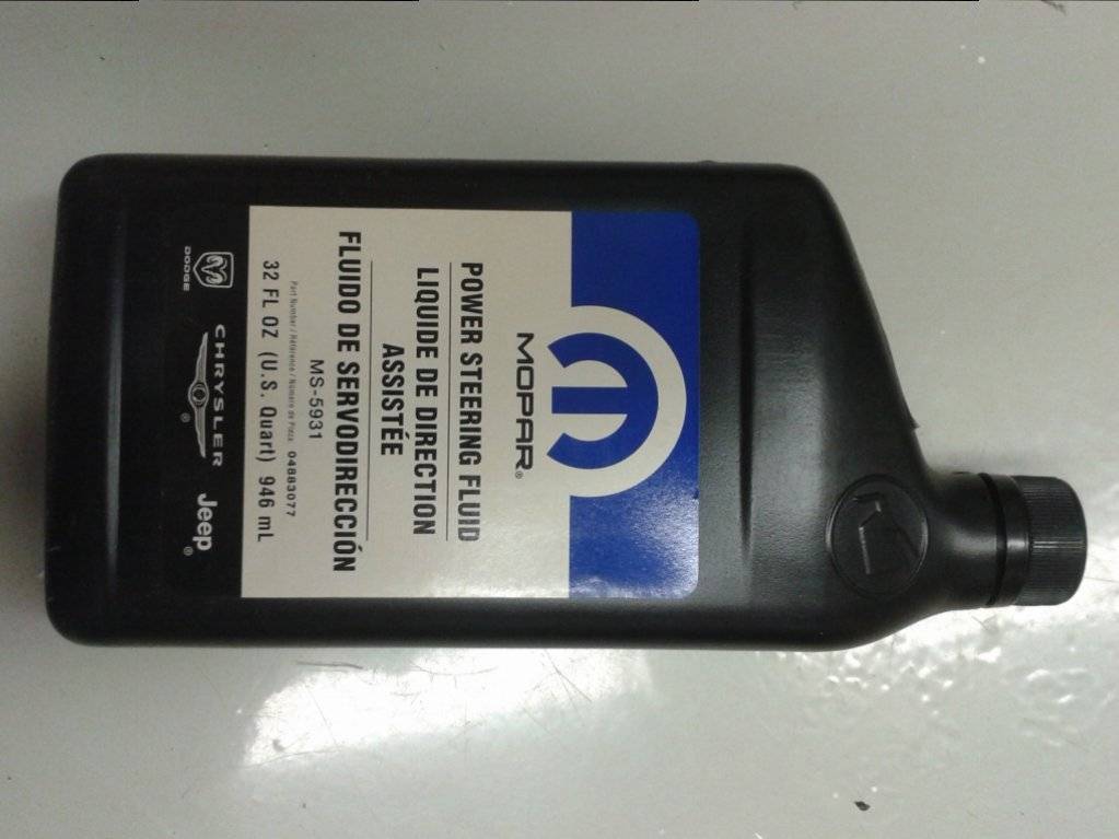

The 1.06 PS pump runs at very high temp. Regular ATF boils, which cooks the seals. They simply melt down. Consequently, the pump will start to leak. Mopar Power Steering Fluid can stand higher temperatures than ATF. This is what I'm using:
The 1.06 PS pump runs at very high temp. Regular ATF boils, which cooks the seals. They simply melt down. Consequently, the pump will start to leak. Mopar Power Steering Fluid can stand higher temperatures than ATF. This is what I'm using:View attachment 90705

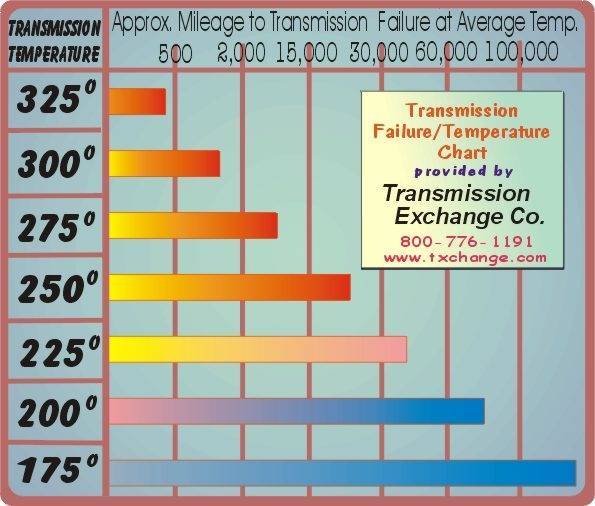

Degradation of fluid is a function of temperature and time. Consider that the fluid temperature in your torque converter is always notably higher than the 'measured' temperature, which is generally recorded in the sump. If we were to measure temperature somewhere other than the sump, that temperature chart would have all of us taking a taxi straight to the oil-cooler store to put a 30k GVW cooler on our cars.
In my younger years I saw similar charts and thought if I could get my trans down below 175 it would be such a great thing. But years later, after working with knowledgable people (sorry txchange.com) I learned you don't want your fluid running that cool, as it's not in its intended viscosity range to perform its job to its best ability. Too hot is not good, but cooler is not necessarily better.
