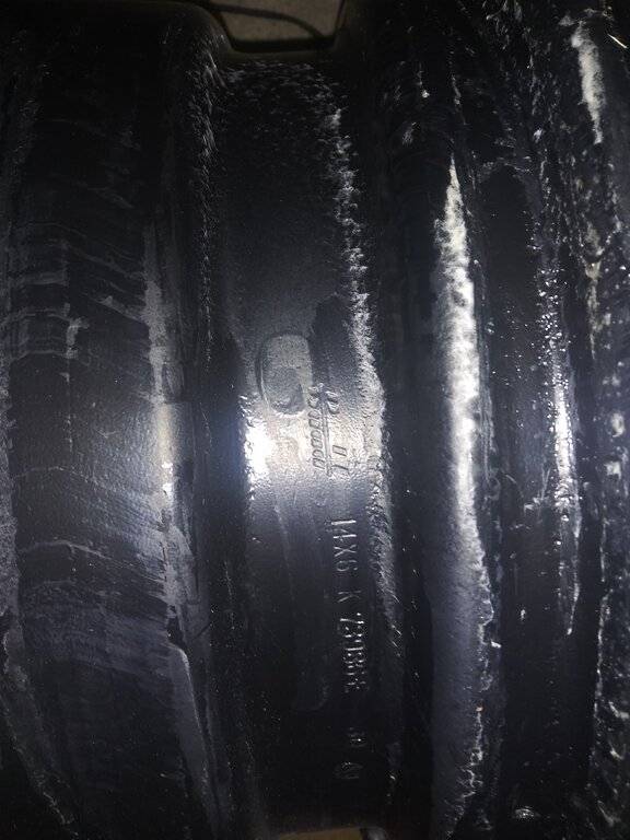

You can see the size and part number on this '66 14x6 K wheel.

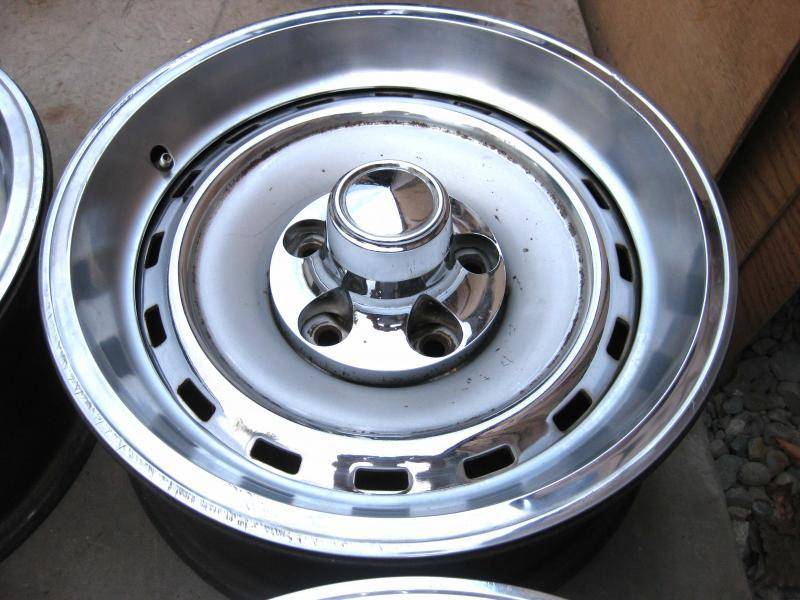

Sorry, I meant these Chrysler Road Wheels. Are they all 15x6? Should have included a picture
I have an ad up here wanting one to finish my set of 3
Sorry. I don't have any. I was considering them for my 1970 Fury because of rust issues with my current aftermarket rims. What size are your rims? Are you going to run 235/70R15 or something else?
